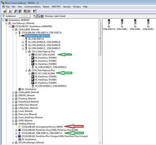

**Author:** ![Jim\_Perks](https://avatars.discourse-cdn.com/v4/letter/j/ec9cab/32.png) [@Jim\_Perks](https://forum.inductiveautomation.com/u/Jim_Perks)\
**Post date:** [May 25, 2022, 11:02am UTC](https://forum.inductiveautomation.com/t/1756-l71-v20-11-connection/59979/12 "2022-05-25T11:02:12Z")
@JordanCClark could be.However, I can connect to other PLCs
Green arrow, I can connect. In red, I cannot. using Igntion. Going online from RSlinx i can all day long.

**Post date:** [May 25, 2022, 12:48pm UTC](https://forum.inductiveautomation.com/t/1756-l71-v20-11-connection/59979/13 "2022-05-25T12:48:41Z")
I don’t believe Ignition ever goes through RSLinx as a simple router. Some people connect to it as an OPC server.
It doesn’t matter whether RSLinx can connect (all day long or not). The RSLinx instance is in the same subnet as the target. I haven’t seen the IP address information for the Ignition Gateway itself. The path from there is what matters.
@Jim_Perks: Please share the IP address information from the upper right of the Gateway’s status overview page.

**Post date:** [May 25, 2022, 2:41pm UTC](https://forum.inductiveautomation.com/t/1756-l71-v20-11-connection/59979/16 "2022-05-25T14:41:17Z")
Also, your RSLinx screenshot points to problems with 172.16.198.108, but you claim above to be trying to reach 172.16.198.89. Please expand that latter in RSLinx so we can see the backplane.
Any unrecognized device, if a Rockwell product, can have its EDS uploaded and registered so it shows up correctly.
