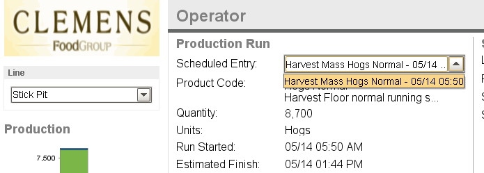

Hey guys,
I’m having a problem with schedules not auto starting after the upgrade to 7.6. The last couple of days I’ve had some lines that will not auto start schedules. I also can not manually start the schedules because the schedule controller can not find the schedules that were entered, which I believe is the root of the problem.
It seems that the schedule controller is having trouble finding schedules that were entered the day before. Yesterday when I entered the schedules for today I could pick those schedules in the line schedule selector and today those schedules are not selectable (they do not appear in the drop down). However, if I go to the schedule entry screen all of the schedules that I entered are there for every line. I went through the console and there are no error that I can see that have anything to do with the OEE/downtime module. Is there something else that I can check or is this a known issue? I would at least like to be able to start the entered schedules manually, but I can’t even do that. If you have any ideas let me know. Thanks!

**Author:** ![Duffanator](https://sea1.discourse-cdn.com/inductiveautomation/user_avatar/forum.inductiveautomation.com/duffanator/32/3560_2.png) [@Duffanator](https://forum.inductiveautomation.com/u/Duffanator)\
**Post date:** [May 15, 2013, 3:41pm UTC](https://forum.inductiveautomation.com/t/7-6-auto-schedule-start-problems/6479/4 "2013-05-15T15:41:42Z")
Ok, is there anything I can look for in the logs or in the database to see if, when or how the run was started/ended? I see auto start entries in the logs for the lines that actually did start, but not for the ones that didn’t. Here’s the schedule entries and what I can pick in the schedules run selector:

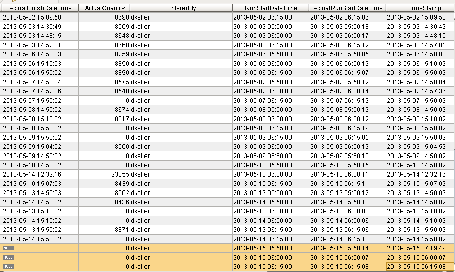

**Post date:** [May 15, 2013, 6:08pm UTC](https://forum.inductiveautomation.com/t/7-6-auto-schedule-start-problems/6479/6 "2013-05-15T18:08:42Z")
According to the analysis screen, none of the runs that did not auto start are scheduled and did not autostart:

I also looked in the schedule database table and it does look like there are datetimes entered in for the start, but for some reason it doesn’t think they are started:
