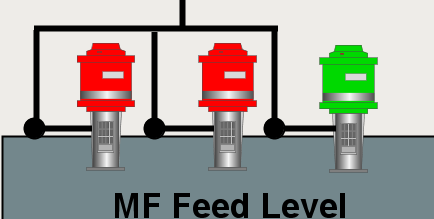

Version 7.9.13
have hatched indication on pump in view window
![image](https://us1.discourse-cdn.com/inductiveautomation/original/3X/3/3/33f97a87a3a67567488e67dceff8f107b4ccc792.png)
But designer shows correctly
![image](https://us1.discourse-cdn.com/inductiveautomation/original/3X/d/5/d531de729245761ee6d2e4a3c89daa1fcce1277d.png)
How do I fix the client?

That looks like an access restriction/security setting on the tag and/or components involved. Start there.

that got me going to find the cause… odd settings on 3rd party system.
