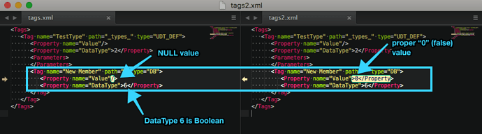

One thing to be careful of when editing UDT’s in the Designer is _NULL_ values… I think some of this issue might have been addressed in 7.9.4, but I’d still look out for it. For example, if you create a new data type, and add a tag to it and change [from Integer] to Boolean and save, you’ll have instances of that type (along with the type itself) have _NULL_ values for that tag. This is especially tricky for Boolean data types since they don’t show _NULL_ in the designer, only a check box. You have to “wiggle” the value (change to true, apply, change back to false, apply, for example) to ensure that instances start with a correct value. This might be something to look at when you’re having things fail to resolve (which can happen due to null-coalescing) properly. Here is an image showing the data type export and what to look out for:
 ![](https://us1.discourse-cdn.com/inductiveautomation/original/2X/2/2d2d9835b8ffaa3565f10a97a5c0750a26b1ebc6.png)
Again, this might not be your issue, but I’ve struggled in debug on a few things until I discovered this behavior.
