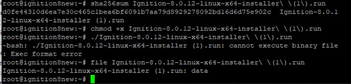

Can’t install 8.0.12
```auto
./Ignition-8.0.12-linux-x64-installer.run --mode text
-bash: ./Ignition-8.0.12-linux-x64-installer.run: cannot execute binary file: Exec format error
Comparing 8.0.12 to 8.0.11:
```auto
$ file Ignition-8.0.12-linux-x64-installer.run
Ignition-8.0.12-linux-x64-installer.run: data
```auto
$ file Ignition-8.0.11-linux-x64-installer.run
Ignition-8.0.11-linux-x64-installer.run: ELF 64-bit LSB executable, x86-64, version 1 (SYSV), dynamically linked, interpreter /lib64/ld-linux-x86-64.so.2, for GNU/Linux 2.4.0, stripped
**Post date:** [April 24, 2020, 2:32pm UTC](https://forum.inductiveautomation.com/t/8-0-12-linux-installer-exec-error/34199/2 "2020-04-24T14:32:31Z")
Any chance your download got truncated?
```auto
kevin@kevin-x1 ~/Downloads> file Ignition-8.0.12-linux-x64-installer.run
Ignition-8.0.12-linux-x64-installer.run: ELF 64-bit LSB executable, x86-64, version 1 (SYSV), dynamically linked, interpreter /lib64/ld-linux-x86-64.so.2, for GNU/Linux 2.4.0, stripped
kevin@kevin-x1 ~/Downloads> sha256sum Ignition-8.0.12-linux-x64-installer.run
d0fe44310d6ea7e30c465c1bea6bf6091b7aa79d8929278092bd16d6d75e902c Ignition-8.0.12-linux-x64-installer.run

**Post date:** [April 24, 2020, 3:16pm UTC](https://forum.inductiveautomation.com/t/8-0-12-linux-installer-exec-error/34199/4 "2020-04-24T15:16:42Z")
What OS/Arch are you running that on?

**Post date:** [April 24, 2020, 4:29pm UTC](https://forum.inductiveautomation.com/t/8-0-12-linux-installer-exec-error/34199/6 "2020-04-24T16:29:50Z")
Hmm. Interesting. What are the output of these two commands?
1. `uname -a`
2. `ldd Ignition-8.0.12-linux-x64-installer.run`

**Author:** ![cbiela](https://avatars.discourse-cdn.com/v4/letter/c/a87d85/32.png) [@cbiela](https://forum.inductiveautomation.com/u/cbiela)\
**Post date:** [April 24, 2020, 5:00pm UTC](https://forum.inductiveautomation.com/t/8-0-12-linux-installer-exec-error/34199/8 "2020-04-24T17:00:28Z")
It may be since I’m using a container in proxmox as my main server.
