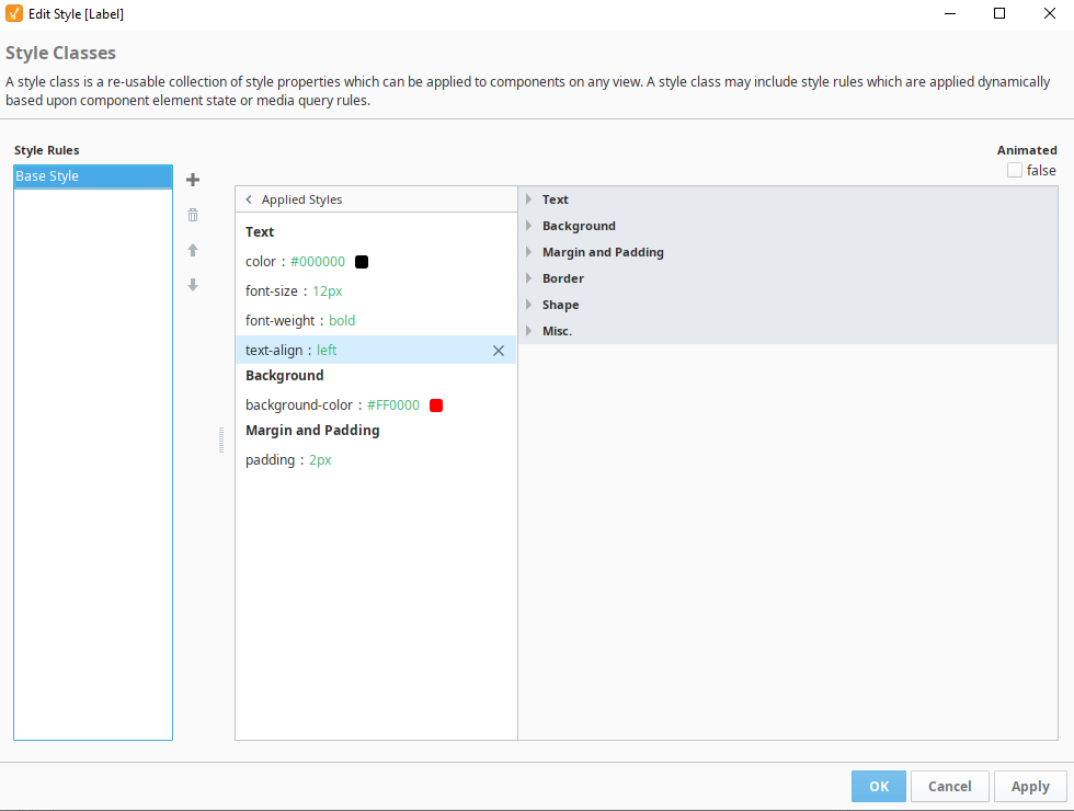

8.0.13 RC Text Field styledoesn’t work in browser
Browser
 ![image](https://us1.discourse-cdn.com/inductiveautomation/original/2X/f/fa62a89ad56a44eac6e20d883121b2ac73e7cd9f.png)
vs
Designer
 ![image](https://us1.discourse-cdn.com/inductiveautomation/original/2X/5/5962799c49ca601968e7f50276f4bebd54baa4c7.png)
**Author:** ![cmallonee](https://sea1.discourse-cdn.com/inductiveautomation/user_avatar/forum.inductiveautomation.com/cmallonee/32/6416_2.png) [@cmallonee](https://forum.inductiveautomation.com/u/cmallonee)\
**Post date:** [May 26, 2020, 4:01pm UTC](https://forum.inductiveautomation.com/t/8-0-13-rc-text-f/35035/2 "2020-05-26T16:01:40Z")
Your screenshots don’t tell us anything about the styles applied to your Text Field - in fact, the photo in which you claim the Text Field is working correctly doesn’t even contain a Text Field. Could you supply better photos of the styling you expect to see? Could you possibly provide us with the view.json file for the View in use?
**Author:** ![wmbrits7](https://avatars.discourse-cdn.com/v4/letter/w/f1d935/32.png) [@wmbrits7](https://forum.inductiveautomation.com/u/wmbrits7)\
**Post date:** [May 27, 2020, 7:15am UTC](https://forum.inductiveautomation.com/t/8-0-13-rc-text-f/35035/3 "2020-05-27T07:15:05Z")

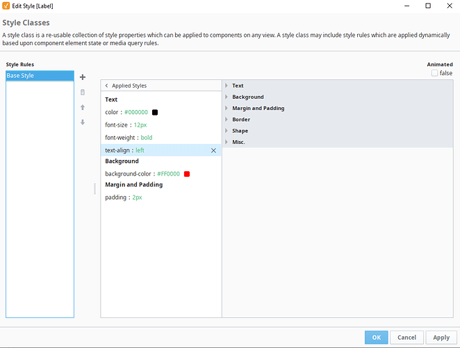

Style that is applied:
 ![image](https://us1.discourse-cdn.com/inductiveautomation/original/2X/f/fa3eca55e725cc6e8aced14a4163e1c13aa21bd5.png)
Designer:
 ![image](https://us1.discourse-cdn.com/inductiveautomation/original/2X/8/8bb39273edcfccb4dea4f24fe91a45d8879221c3.png)
Browser:
 ![image](https://us1.discourse-cdn.com/inductiveautomation/original/2X/3/33aad6a85065186989dd242246f37466e88d9fa0.png)
As you can see the label component keeps the style applied but not the text field
**Post date:** [May 27, 2020, 7:20am UTC](https://forum.inductiveautomation.com/t/8-0-13-rc-text-f/35035/4 "2020-05-27T07:20:58Z")
[TextField.zip](https://forum.inductiveautomation.com/uploads/short-url/fz6cfNMPJespm6kh46MerAryw0S.zip) (2.3 KB)
**Post date:** [May 28, 2020, 4:19pm UTC](https://forum.inductiveautomation.com/t/8-0-13-rc-text-f/35035/5 "2020-05-28T16:19:07Z")
> [@Perspective TextField no longer applying styles outside of designer](http://forum.inductiveautomation.com/t/perspective-textfield-no-longer-applying-styles-outside-of-designer/34845/2):
> Fix went in the 8.0.13 release branch yesterday. It will fixed in the next 8.0.13 release, which will likely be the final.
