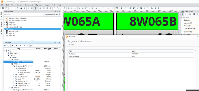

![image](https://us1.discourse-cdn.com/inductiveautomation/original/3X/d/2/d2e22231a022599f90dd5c9c0596ef644883e3f0.png)
have to add the quotes in the tag editor and then remove them in the tag browser.
other wise it will strip off the Wxxx and leave the 8 as an integer.
**Author:** ![ggross](https://sea1.discourse-cdn.com/inductiveautomation/user_avatar/forum.inductiveautomation.com/ggross/32/12668_2.png) [@ggross](https://forum.inductiveautomation.com/u/ggross)\
**Post date:** [June 30, 2020, 6:15pm UTC](https://forum.inductiveautomation.com/t/8-0-14-udt-parameters-data-type-defaults-to-integer-when-string-starts-with-number/36191/2 "2020-06-30T18:15:56Z")
This is a known issue that is resolved in the nightly build of Ignition and will be part of 8.0.15 when it is released.
