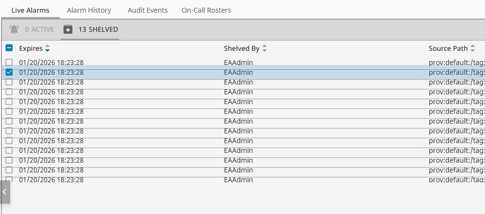

Is there a way to apply separate row height properties to the shelved alarm rows? My active alarms have a row height of 20 which displays correctly using the previously discussed method. However, when I open the shelved alarm view each of the row’s text overlaps the above row’s gridline. I believe the row “overlay” is displaying a height of 30p but each row’s gridline is set to a height of 20p.
 ![Shelved Alarm Overlap](https://us1.discourse-cdn.com/inductiveautomation/original/3X/4/7/47fb711f1a3f4ea0dbeaf26dfe5c0b236a8c0d74.jpeg)

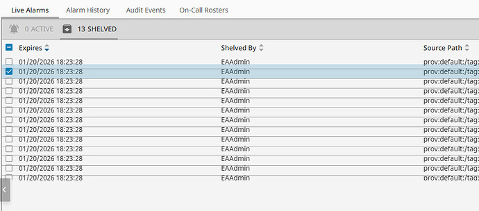

Interestingly, when I inspect element on a row the view corrects and displays each row overlay/gridline height as 30p.
 ![Inspect Element Shelved Alarm Row](https://us1.discourse-cdn.com/inductiveautomation/original/3X/e/b/ebd878b09fb803486466c27c66ddb077b679a588.jpeg)
Each of my rowStyles is configured as pictured below
