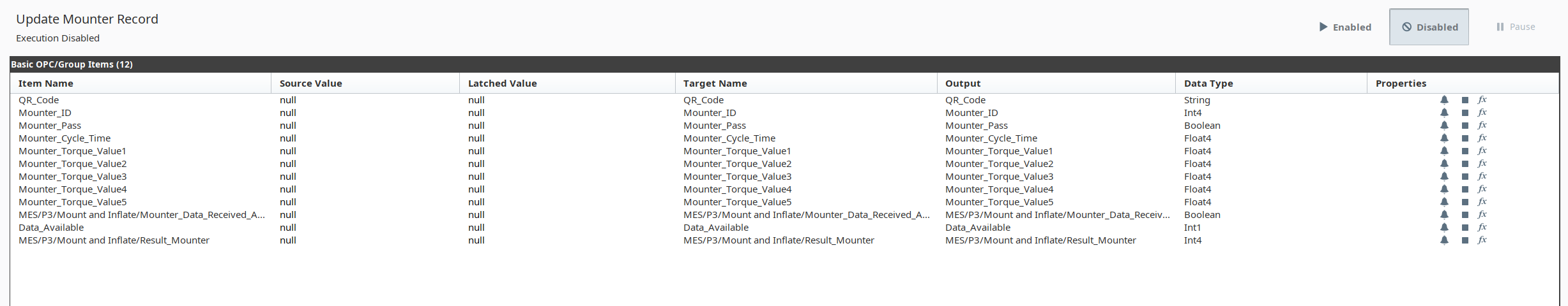

Hi all,
We recently upgraded to 8.1.38 and I have noticed some differences in the way our Stored Procedure Transaction Groups display information. Before the upgrade, the target of the datapoints (target name inside of the SP) showed up in the overview of the transaction group in the Target Name column and the Output column would show 'None' if that datapoint didn't output to anything. Now, after the upgrade, everything under both the Target Name and Output column's just shows the name of the datapoint (see example below).
 ![image](https://us1.discourse-cdn.com/inductiveautomation/original/3X/8/3/8304a304441725bb80efb216ea3efc6613493b47.png)
In addition, you can no longer change the Target Name or Output with a dropdown directly in the transaction group itself, you have to edit the datapoint and change it there.

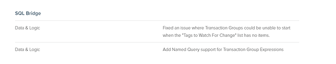

I looked at the patch notes for 8.1.38 and don't see any of these changes mentioned.
 ![image](https://us1.discourse-cdn.com/inductiveautomation/original/3X/9/0/90876c7f828703962cdb7e3b49bf63d43748a702.png)
Did I miss something or is this some sort of bug?

I wrote to the support for the same problem with Standard Group.
They have an open bug ticket about it. And they confirmed that this issue popped up on 8.1.38.
