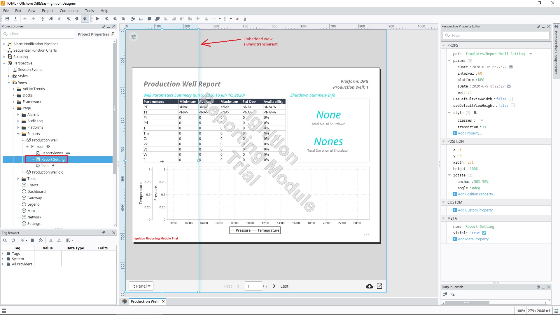

The interesting is any embedded view I add in this view show full transparent as shown in below image.
[TOTAL\_2020-09-23\_0813.zip](https://forum.inductiveautomation.com/uploads/short-url/ffie0lYJZNX5jPjXmaXCCaZe0YI.zip)
 ![report](https://us1.discourse-cdn.com/inductiveautomation/original/3X/7/d/7d6cec6c8013278bbf1513d7ebb223b8f5e94c4d.jpeg)

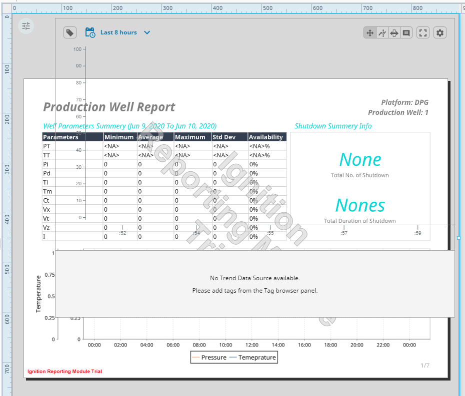

Same happen with powerchart, most of its part render transparent in this view!!!
 ![image](https://us1.discourse-cdn.com/inductiveautomation/original/3X/5/6/56bb55de3cccf8057c75dcb62811948523c2c23a.png)

Thanks. I only find out that this happen in only this view with any embedded view and some comments like powerchart.
**Author:** ![ynejati](https://sea1.discourse-cdn.com/inductiveautomation/user_avatar/forum.inductiveautomation.com/ynejati/32/6093_2.png) [@ynejati](https://forum.inductiveautomation.com/u/ynejati)\
**Post date:** [October 8, 2020, 4:07pm UTC](https://forum.inductiveautomation.com/t/8-1-report-component-cause-other-pages-not-open/38915/11 "2020-10-08T16:07:53Z")
Okay. I think the issue is actually with the ReportViewer. Using the project you provided, if the report does not load, your page does not load. This is a regression and will be fixed in rc3.
