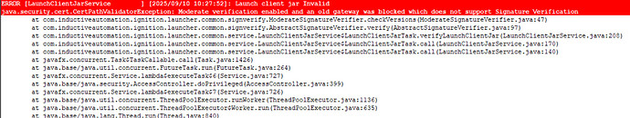

I’m getting the following error after upgrading the designer:
```python
java.security.cert.CertPathValidatorException: Moderate verification enabled and an old gateway was blocked which does not support Signature Verification
 ![image](https://us1.discourse-cdn.com/inductiveautomation/original/3X/8/9/89d843574484e715e662c2657ad74deeb7b56901.png)
 ![image](https://us1.discourse-cdn.com/inductiveautomation/original/3X/6/4/646402d6258a9f56510872144521ce85e4d600dc.jpeg)

There is a default signature verification check (set to `MODERATE`) that will prevent launching against gateway versions 8.1.33 and older. You can reconfigure this check in the launcher `.json` files to be `LENIENT/LOOSE` which will allow these “legacy” gateways.

Something to add here is this JSON file should be modified with all Designer Launchers closed, otherwise it will rewrite the original settings on exit.

> [@Daniel\_Kearney](#):
> LENIENT/LOOSE
This should say “`LENIENT` or `LOOSE`" unless i’m mistaken… using the literal string “LENIENT/LOOSE” gets overwritten with `null`. Setting it to `LOOSE` made mine start working
**Post date:** [October 29, 2025, 11:32pm UTC](https://forum.inductiveautomation.com/t/8-3-designer-unable-to-open-ignition-8-0-4-gw/110509/5 "2025-10-29T23:32:19Z")
Yes, that's right, those are two different values.
The full list:
- `LOOSE` - No revocation checks; allows unsigned jars for older gateways ⚠
- `LENIENT` - Revocation checks not required (soft fail); allows unsigned jars for older gateways ⚠
- `AIR_GAPPED` - No revocation checks at all; allows unsigned jars for older gateways ⚠
- `MODERATE` - Enforces CertPath checks (except expiration) with soft-fail revocation checks
- `STRICT` - Fully enforces CertPath checks (except expiration) including revocation checks ✓
(AI summarized obviously)
edit: ah that list is already in the linked docs!
