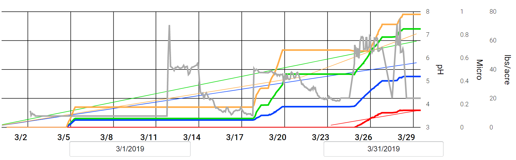

- There’s a ton of wasted space with multiple axes in the chart, and this is with one more inside the pH hidden (and ‘rendered’ inside, because leaving it outside but not visible only makes it white, meaning even more wasted space):
 ![chart](https://us1.discourse-cdn.com/inductiveautomation/original/2X/c/ccf2ee25589b9e794d8d4eb72b0c886df7471fb2.png)

5. I don’t quite understand what you’re asking here. Keep in mind that we are not completely satisfied with our current charting library, and are considering other options at the moment.
6. I am not seeing this issue. Can you provide more specifics on how to replicate. Thanks!

I can’t replicate #6 at the moment either, if I get the red ERROR again I’ll try to make a test case.
