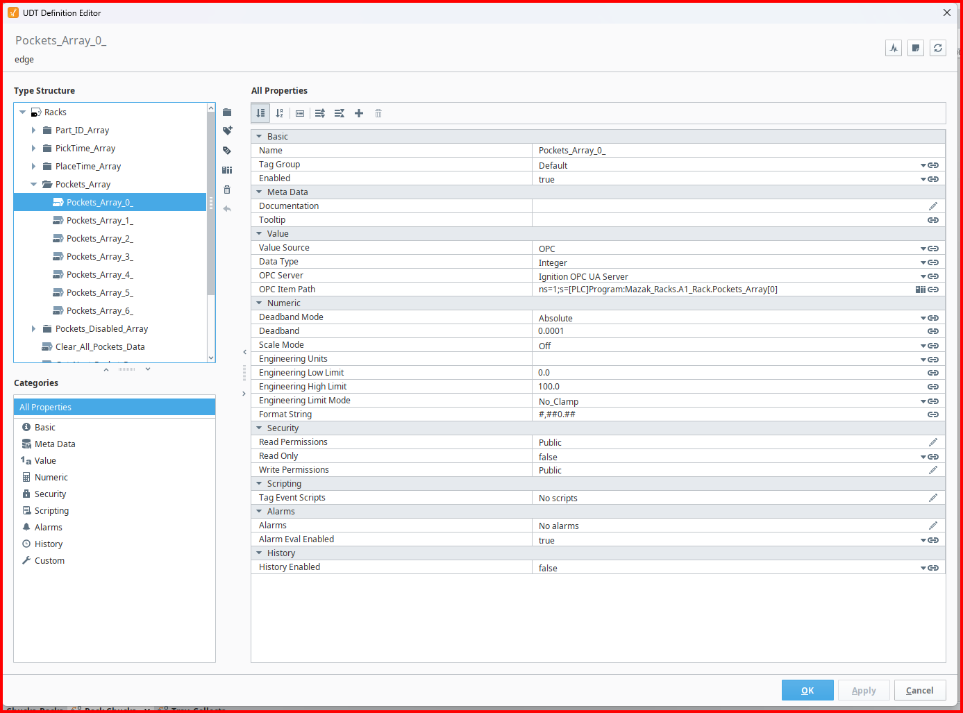

I have the arrays shown below inside an Ignition UDT definition that looks something like this:
1. A1\_Rack.Part\_ID\_Array[224] type STRING
2. A1\_Rack.PickTime\_Array[224] type DINT
3. A1\_Rack.PlaceTime\_Array[224] type DINT
4. A1\_Rack.Pockets\_Disabled\_Array[224] type BOOL
5. A1\_Rack.Pockets\_Array[224] type BOOL
Can you please explain the issues I'm having when I instantiate these five arrays? When I browse to the tags Items 1,2,3 shows all 224 elements while 4 and 5 (of type Booleans) only shows 6 elements

Bool arrays in CLX are actually DINTS behind the scenes. 7 DINTS x 32bits = 224 bits.
**Post date:** [August 8, 2025, 5:39pm UTC](https://forum.inductiveautomation.com/t/ab-compact-logix-boolean-array-not-showing-full-array-size-in-udt/109544/3 "2025-08-08T17:39:50Z")
Logix BOOL arrays are actually packed into DWORD arrays with nothing visible to external connections to indicate they’re actually a BOOL array.

How do I access Individual elements?
**Author:** ![ryan.white](https://sea1.discourse-cdn.com/inductiveautomation/user_avatar/forum.inductiveautomation.com/ryan.white/32/73193_2.png) [@ryan.white](https://forum.inductiveautomation.com/u/ryan.white)\
**Post date:** [August 8, 2025, 5:43pm UTC](https://forum.inductiveautomation.com/t/ab-compact-logix-boolean-array-not-showing-full-array-size-in-udt/109544/5 "2025-08-08T17:43:21Z")
You can access bits by adding `.#` to the tag path where `#` is the index of the bit in that DWORD, so anything from 0-31.
For example, item `A1_Rack.Pockets_Array[122]` in CLX would be `ns=1;s=[PLC]Program:Mazak_Racks.A1_Rack.Pockets_Array[3].26`
**Post date:** [August 8, 2025, 5:58pm UTC](https://forum.inductiveautomation.com/t/ab-compact-logix-boolean-array-not-showing-full-array-size-in-udt/109544/6 "2025-08-08T17:58:27Z")
You can also create an Ignition UDT to individualize the bits into individual tags…that's what I do with 32 bit DiNTs for alarm bits. Just create a UDT type with a string root parameter, then individual bits that are {root}.0 to {root}.31. Makes it easier to define alarms, bindings, etc

For your case, if you want specific array.y tags, expand the UDT to add an INDEX parameter, and change the elements to include the [INDEX] to your CLX tag.
