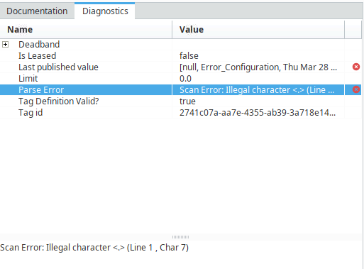

I want to place an indicator on a Vision page to indicate if Daylight Saving Time is on.
In the Script Console, system.date.isDaylightTime() works fine.
I have Boolean Tag called "DST" with value source as expression. For the expression i have system.date.isDaylightTime(now()). This doesn't go down well:
![image](https://us1.discourse-cdn.com/inductiveautomation/original/3X/4/f/4fd0d7b6736741c016858a73889f8ccddacecc0e.png)
I have tried many variety of the expression. Doesn't work. What am I doing wrong here?
Have a wonderful break, All. Thanks.
**Post date:** [March 28, 2024, 8:41am UTC](https://forum.inductiveautomation.com/t/about-isdaylighttime/88015/2 "2024-03-28T08:41:17Z")
`system.date.isDaylightTime(now())` is not an **expression**. It is a **script**.
Expression Language has [dateIsDaylight | Ignition User Manual](https://docs.inductiveautomation.com/docs/8.1/appendix/expression-functions/date-and-time/dateIsDaylight) so try:
`dateIsDaylight(now())`

Thanks Transistor. Works perfectly. Understood why I was getting the error.
