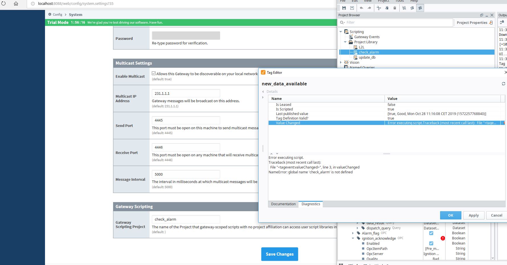

I have no experiance with Ignition, I just started acouple of months ago, I’m developing a Special application for our platform, could you tell me please where I could find the Setting that could I used it to set the global Scripting Project in the Gateway configuration Webpage, I didn’t foud a such config!!
**Author:** ![sarmad.al-rubaye](https://avatars.discourse-cdn.com/v4/letter/s/a5b964/32.png) [@sarmad.al-rubaye](https://forum.inductiveautomation.com/u/sarmad.al-rubaye)\
**Post date:** [October 28, 2019, 10:43am UTC](https://forum.inductiveautomation.com/t/access-a-table-component-in-gatwayevent-script-and-access-a-project-library-function-in-tag-value-change-event/29387/6 "2019-10-28T10:43:08Z")
I tried this but it doesn’t work.
 ![global%20script](https://us1.discourse-cdn.com/inductiveautomation/original/2X/9/9ae1686bca850492aa981698af08ac7369b512fb.jpeg)
**Post date:** [October 28, 2019, 12:25pm UTC](https://forum.inductiveautomation.com/t/access-a-table-component-in-gatwayevent-script-and-access-a-project-library-function-in-tag-value-change-event/29387/7 "2019-10-28T12:25:44Z")
So you’ve found the right place, but you’re setting the global scripting **project** to a script library. Set this to the name of your project instead. Normally you would create an inheritable project, for example called Global, which you would use across multiple projects to store base functionality such as script libraries, templates, etc. Then you would set the global scripting project to this global project

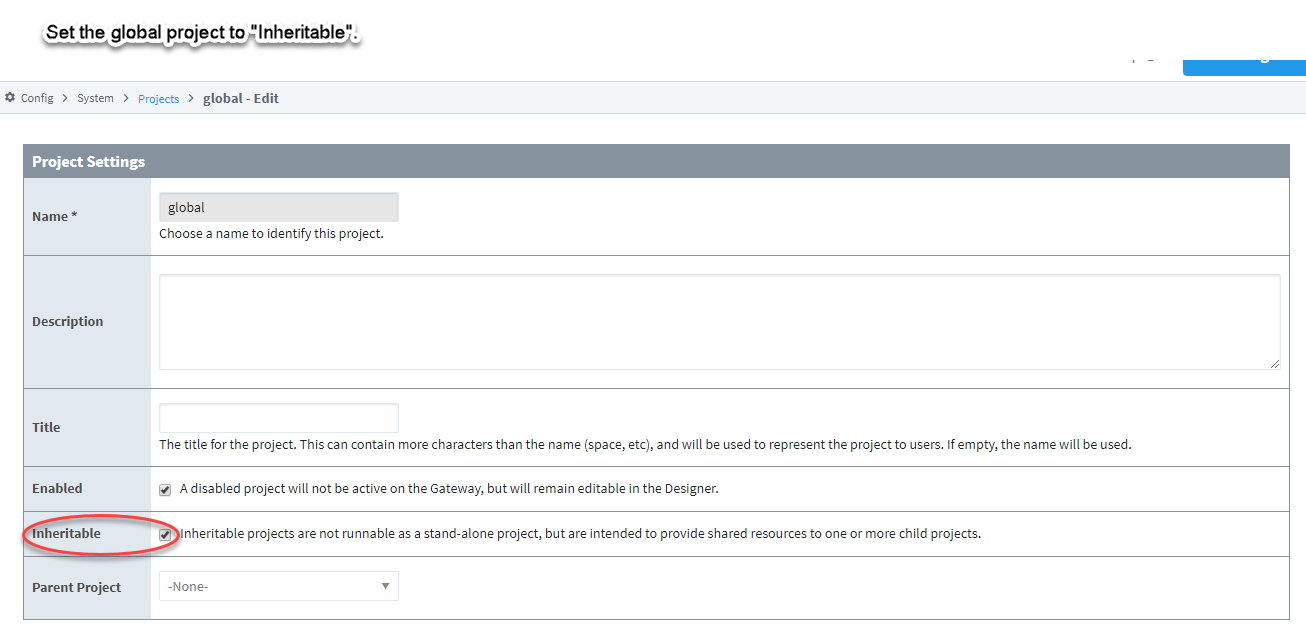

**Post date:** [October 28, 2019, 2:02pm UTC](https://forum.inductiveautomation.com/t/access-a-table-component-in-gatwayevent-script-and-access-a-project-library-function-in-tag-value-change-event/29387/8 "2019-10-28T14:02:20Z")
To expand upon Nick’s answer:
 ![2019-10-28_8-41-42](https://us1.discourse-cdn.com/inductiveautomation/original/2X/d/d0d744a496bd854ce384f79420150803ba55c784.png)
