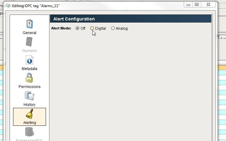

I am creating a screen to configure generic alarms that are already in a DBprovider folder.
I have been able to UPDATE and INSERT queries into sqlt\_core and sqlt\_as for the alert tags.
What I cannot find is where the type of alert is stored.
 ![](https://us1.discourse-cdn.com/inductiveautomation/original/1X/6e7f388d36bf9cabf611c618e7b2f26a86f63656.jpg)

That is stored in the sqlt\_meta table. You will find a row with the tag id and a name with value ‘AlertMode’.

Thanks Travis,
when I was looking at sqlt\_meta I missed that as I had to scroll right down to the bottom of the Query Output to find those.
