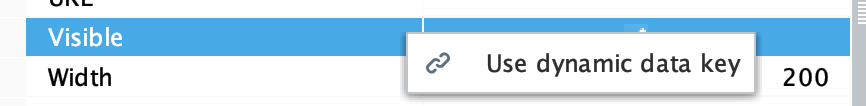

I want to be able to generate a report that has an arbitrary number of charts based on the number of machines at a given facility, but from what I can see, this isn't possible. If the "visible" property could be bound to some data property, I could just hardwire the maximum number of charts, and toggle as needed (ugly, but still doable). ~~The fact that this property exists but is completely useless confounds me.~~
Am I missing something? Surely I can't be the first to want to achieve this...
**Post date:** [June 20, 2025, 4:40pm UTC](https://forum.inductiveautomation.com/t/achieving-equivalent-of-a-repeater-in-a-report/107629/2 "2025-06-20T16:40:27Z")
> [@Ryan\_Deardorff](#):
Well, good news on that front:
 ![image](https://us1.discourse-cdn.com/inductiveautomation/original/3X/e/b/eb570f220f4b4f8f6c94486c9c844ff545d45517.png)
> **[Data Keys | Ignition User Manual](https://docs.inductiveautomation.com/docs/8.1/ignition-modules/reporting/report-design/data-keys#dynamic-data-keys)**
> In the Reporting Module, we use Data Keys to pull values from data sources and show them on the report. In simple terms, Data Keys are placeholders for your data. The simplest reference to data is a simple Data Key. At report generation time, these...
But I would say the better pattern would be to structure your data as a nesting and use a **table** component (with an "unstructured" row containing the chart) - that way you get automatic repetition of N charts for whatever size N is your input. That makes the "hard" part structuring your input data.
