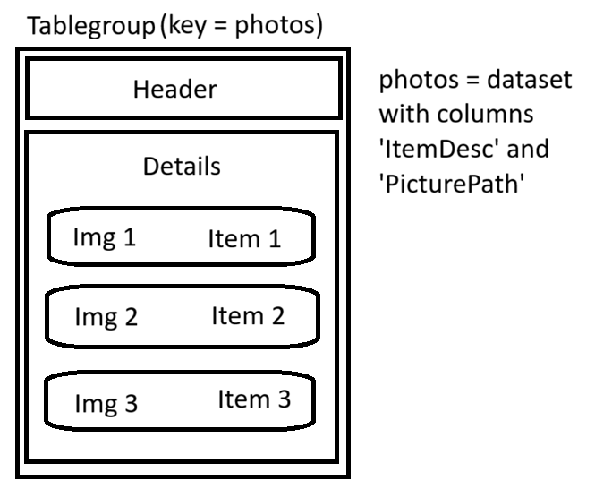

I have a Table group where one of the peer tables has a key called 'photos'. 'photos' is a dataset with columns ItemDesc and PicturePath. I need to display all the lines in the dataset as separate items on the report. If there are a 100 items in the dataset this could take up several pages.
 ![image](https://us1.discourse-cdn.com/inductiveautomation/original/3X/b/5/b53e76fda5e62ec07bc95bc4f313d1cafa873aaa.png)
How do I add a table that can repeat an Image component?

Close but that person is loading blobs from a database. I just have a list of file paths, that I will check exist, and then load them into images.
After typing it all out I remembered I could make the 'photos' a list of numbers / pointers and then add an unstructured table to the details section. This unstructured table is repeated for every number / pointer from 'photos'.
But I am stuck on using the pointer still.
**Post date:** [January 8, 2026, 6:52pm UTC](https://forum.inductiveautomation.com/t/add-a-dynamic-number-of-photos-to-a-report/113157/4 "2026-01-08T18:52:14Z")
Consider a scripted data source that retrieves the file bytes. Probably nested for a table group.

Would I add the file bytes to a dataset line entry after reading them? Is that the concept you are going for?
