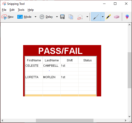

Ah… so implementing the isCellEditable function allow me to type in the field, but when I also select the
editable checkbox in the table customizer, then the Pass/Fail dropdown shows up…
but when I select either one, nothing actually shows up… LOL

**Post date:** [March 3, 2021, 6:38pm UTC](https://forum.inductiveautomation.com/t/add-drop-down-box-to-power-table/43940/13 "2021-03-03T18:38:29Z")
Are you also implementing `onCellEdited` or whatever it’s called? You need to write the selected value from the dropdown back to the dataset to actually change anything.
**Author:** ![toddayers](https://avatars.discourse-cdn.com/v4/letter/t/8baadc/32.png) [@toddayers](https://forum.inductiveautomation.com/u/toddayers)\
**Post date:** [March 3, 2021, 6:42pm UTC](https://forum.inductiveautomation.com/t/add-drop-down-box-to-power-table/43940/14 "2021-03-03T18:42:49Z")
Ah… I believe that was it! Thank you very much…
