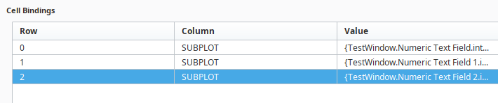

Another way would be to use a cell update binding on the pens dataset to control the plot values in conjunction with numeric text fields that have their minimum and maximum values representing the number of plots. This way, invalid entries couldn't be made that would break the binding:
 ![image](https://us1.discourse-cdn.com/inductiveautomation/original/3X/e/a/ea1ad5f6a58fe461d99ef9eb00ed32296da30aed.png)
![image](https://us1.discourse-cdn.com/inductiveautomation/original/3X/e/0/e0e3d5dbfc4067777ed2bf219444d48bde412763.png)
I suppose the numeric textfield could alternatively be thrown into a template and a template repeater used to keep the number of textfields and their respective locations dynamic. Then, scripting could be used instead of a binding to write the subplot value, but I imagine at this point there are enough examples in this post to find inspiration or direction.

Great examples! I think the cell update binding would be the easiest for me.
