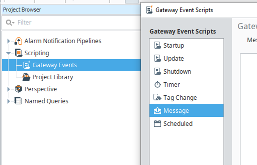

**Author:** ![pascal.fragnoud](https://sea1.discourse-cdn.com/inductiveautomation/user_avatar/forum.inductiveautomation.com/pascal.fragnoud/32/24728_2.png) [@pascal.fragnoud](https://forum.inductiveautomation.com/u/pascal.fragnoud)\
**Post date:** [December 9, 2021, 8:51am UTC](https://forum.inductiveautomation.com/t/add-edit-delete-tags-from-one-gateway-and-push-changes-to-other-gateway/53878/6 "2021-12-09T08:51:38Z")
Don’t script it on the gateway that sends the message, but on the gateway that receives it.
You put it in the gateway event scripts, there’s a `message` section there:
 ![image](https://us1.discourse-cdn.com/inductiveautomation/original/3X/0/e/0e0c4fab8974f2e9b9ea3d033c2aa3ae695ddf1a.png)
That’s a message handler, let’s call it `testHandler`
In this script, you call `system.tag.configure()` to add your tag, or do whatever you need to do.
Now, in the sending project, when you want to call this script, you just call
```python
target_project = <the name of the receiving project>
target_gateway = <the gateway where the receiving project is>
payload = <a dictionnary of data you want to send, can be empty>
system.util.sendMessage(target_project, 'testHandler', payload=payload, remoteServers=[target_gateway])
`remoteServers` needs to be a list, that why there are `[]` surrounding `target_gateway`.
And that’s it.
