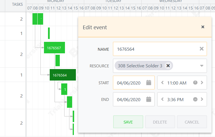

Hello,
I am developing a custom scheduler module for perspective and I am having some trouble with popups. I would like to be able to click on a task in the scheduler and for a popup to appear (I have attached a screenshot of what I mean). Is this possible in perspective? Currently, when I click on a task the popup appears below the scheduler and loses some formatting.
Thank you 🙂
 ![image](https://us1.discourse-cdn.com/inductiveautomation/original/3X/b/6/b6ad7b717619554574adafdf226f861027cd8820.png)
**Post date:** [January 21, 2021, 5:28pm UTC](https://forum.inductiveautomation.com/t/adding-a-popup-to-a-custom-perspective-component/42473/2 "2021-01-21T17:28:21Z")
(I am not a Perspective, React, or JS expert)
It looks like you want to use the `ComponentModal` React class as the base for your popup - from the docstring, it will automatically display where it can fit, and size appropriately for mobile devices.
