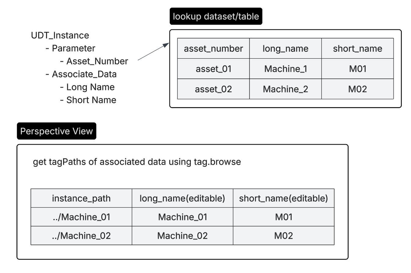

Given a machine UDT. I want to add more details such as machine description, location, short name, long name.
The usual approach i see most developers do, is to use memory tags as place holder on UDT. But I don't find it a good practice.
How I would do it, is to store these details on database. But I don't know how do I setup 1 to 1 relationship, UDT to table’s primary key.
How would you do it?

**Author:** ![Eugene49](https://avatars.discourse-cdn.com/v4/letter/e/c6cbf5/32.png) [@Eugene49](https://forum.inductiveautomation.com/u/Eugene49)\
**Post date:** [December 30, 2025, 2:15pm UTC](https://forum.inductiveautomation.com/t/adding-associate-data-to-udt-via-database/113018/4 "2025-12-30T14:15:20Z")
I see. But i had experience dealing with a hundred UDT instances.. Following the existing implementation, similar to your suggestion above, I added memory tag/custom parameters/properties. – I ended up having to click, edit, each instances to enter details. which is pain to manage.
Was thinking to tie to a database table, probably it is easier to manage. On view startup, query database for more details on the tag..
But I am stuck on thinking, how to identify each UDT instance uniquely, without using its tag path.
**Post date:** [December 31, 2025, 6:22am UTC](https://forum.inductiveautomation.com/t/adding-associate-data-to-udt-via-database/113018/8 "2025-12-31T06:22:35Z")
Thanks for all the input above, I have finally put closure on this.
If Machine UDT Instance have asset number, i would create UDT Parameter Asset\_Number.
And use this Asset\_Number to lookup dataset or database table for associated data.
Another option, next time, if I have to edit hundreds of UDT instance static value, I would create a view, use `system.tag.browse` to get all desired tagPaths and feed it on table component, write to tag on edit cell event.
 ![image](https://us1.discourse-cdn.com/inductiveautomation/original/3X/d/2/d2bc2b70a272d80bf791023e5bd28263ed6eb604.jpeg)
Let me know for any comments, better implementation, I appreciate it.
Thank you.
