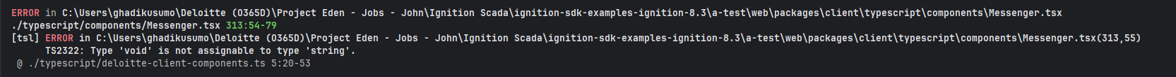

Hi Dear,
I am trying to understand on how the perspective custom module works. I took example **perspective- component** and try to do several modification in order to understand how thing works. So on **messenger.props.json** i had added extra props member which i named it as **value.** It is a string.
 ![image](https://us1.discourse-cdn.com/inductiveautomation/original/3X/f/9/f9f186d7d02f33751b4eaa73d5083e66f320afca.png)
Then i made some changes on **Messenger.tsx** :
 ![image](https://us1.discourse-cdn.com/inductiveautomation/original/3X/e/e/ee3a0dd08987eb770e50dad044f0f51fcafc585c.png)
on **getPropsReducer** i added **valueConfig: tree.read(“value”)** so i can get the value of **value** props member to be used somewhere else in the code later on. Also i need to have a method to update the value of **value** whick i would trigger later on by clicking another additional button. So i added a new method called as **setValueConfig on getPropsReducer** section , and this method which is accepting a string as parameter.
But when i compile the project i got this error message:
**Type “void” is not assignable to type “string”.**
 ![image](https://us1.discourse-cdn.com/inductiveautomation/original/3X/1/c/1ca75a77641ab2b7dc5c7017fc135d92c0a42b47.png)
Just wondering what i did wrong ? is there any way other than this to allow me adding a new method so i can change the value of any props properties ?

This looks like just a Typescript error, adjust your `MessagePropConfig` type to allow `setValueConfig` to be a function.
Right now all string keys (including `setValueConfig`) must have a string value:
```ts
interface MessagePropConfig {
    [key: string]: string;
**Author:** ![Gunawan\_Hadikusumo](https://avatars.discourse-cdn.com/v4/letter/g/c57346/32.png) [@Gunawan\_Hadikusumo](https://forum.inductiveautomation.com/u/Gunawan_Hadikusumo)\
**Post date:** [September 23, 2025, 12:06am UTC](https://forum.inductiveautomation.com/t/adding-method-on-custom-module/110819/3 "2025-09-23T00:06:48Z")
Thanks for replying. This is what i did:
1. Because **MessagePropConfig** interface was used as a reference by **DEFAULT\_MESSAGE\_CONFIG** as well, i created another interface : **resultPropConfig.**
 ![image](https://us1.discourse-cdn.com/inductiveautomation/original/3X/5/2/52263e7b2da638c6fca291ee330621c9ec3889e5.png)
Then i modified the **getPropsReducer** method by replacing its output type reference:
 ![image](https://us1.discourse-cdn.com/inductiveautomation/original/3X/f/4/f41175b37a3c92bfa8e26714bc024249662815d7.png)
After that i compiled the code on terminal and it was successful
![image](https://us1.discourse-cdn.com/inductiveautomation/original/3X/5/c/5c922732e2f7883c8a6f5cbcee3222cc615bf460.png)
Now the issue is : when i tried to execute this new **setValueConfig** method, i got an error :
![image](https://us1.discourse-cdn.com/inductiveautomation/original/3X/b/9/b9af18c581c65a29df39a6ab6e2a31847c92872b.png)
And this is the method which call that new method :
 ![image](https://us1.discourse-cdn.com/inductiveautomation/original/3X/c/b/cb9e123299027d3dedfbb0d96fef6cf84532a1cf.png)
The following below is the complete code: **Messenger.tsx**
**Post date:** [September 23, 2025, 1:20am UTC](https://forum.inductiveautomation.com/t/adding-method-on-custom-module/110819/4 "2025-09-23T01:20:22Z")
After hours i figured out the answer. I had to modified **MessengerComponent** by replacing **MessagePropConfig** with **resultPropConfig**.
![image](https://us1.discourse-cdn.com/inductiveautomation/original/3X/8/5/85662de280d19d5e6e28950a5e22ab0ba1761d63.png)
Now it works like a charm. By anyway thank you for helping me out.
