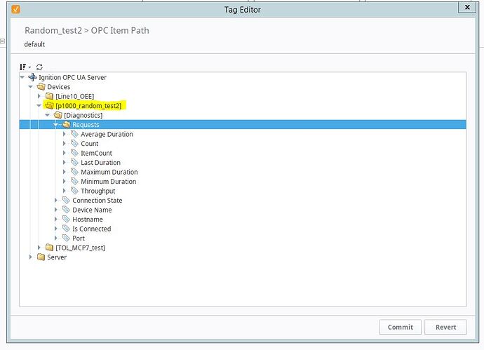

I set up a Production Automation Direct 1000 PLC to generate some random data in productivity suite, with tags: Random1, Random2, Random3. I was able to configure this device as ModBus TCP on ignition 8 and the server shows it’s connected. However, when I try to look for tags created in the pro suite, “Random1”, “Random2”, and “Random3” don’t show up on the drop list.
 ![Capture](https://us1.discourse-cdn.com/inductiveautomation/original/2X/5/554690a34d88a2b5ea7573e15f407c13d1176912.jpeg)
**Post date:** [October 8, 2019, 1:41pm UTC](https://forum.inductiveautomation.com/t/adding-tags-on-v8-designer-launcher/28916/2 "2019-10-08T13:41:26Z")
The Modbus protocol has no notion of browsing or tag enumeration. You have create and manually address OPC tags in the designer for every tag in the controller you want to subscribe to. Somewhere in the PLC programming software you should be able to map variables to registers, or get the mapped register if it happens automatically. Then you can make a tag in Ignition using the Modbus addressing syntax: [https://docs.inductiveautomation.com/display/DOC80/Modbus+Addressing](https://docs.inductiveautomation.com/display/DOC80/Modbus+Addressing)

> [@serenaz](#):
> P1-540
It's silly of me to ask, but just to clarify, what is the name of the device connection on your gateway? Is it `P1-540`, or is it the `p1000_random_test2` device highlighted in your first post?
**Author:** ![serenaz](https://avatars.discourse-cdn.com/v4/letter/s/4af34b/32.png) [@serenaz](https://forum.inductiveautomation.com/u/serenaz)\
**Post date:** [October 8, 2019, 7:42pm UTC](https://forum.inductiveautomation.com/t/adding-tags-on-v8-designer-launcher/28916/10 "2019-10-08T19:42:48Z")
@Paul.Scott Good catch! I had them under different names before. But all the folders and devices now have the same name as the device added in the gateway. I changed them when I was testing out the OPC Item Path.

**Post date:** [October 9, 2019, 3:53pm UTC](https://forum.inductiveautomation.com/t/adding-tags-on-v8-designer-launcher/28916/13 "2019-10-09T15:53:58Z")
Is the OPC Server name correct?
If you did a fresh install of Ignition 8 the default name is slightly different. “Ignition OPC UA Server” without the hyphen.
**Post date:** [October 9, 2019, 4:02pm UTC](https://forum.inductiveautomation.com/t/adding-tags-on-v8-designer-launcher/28916/14 "2019-10-09T16:02:17Z")
@Kevin.Herron
Oh my gosh, that solved the problem! I noticed it before but when I hit commit, the OPC server doesn’t change. I went in and manually took out the hyphen this time, now everything is working! Thank you so much.
