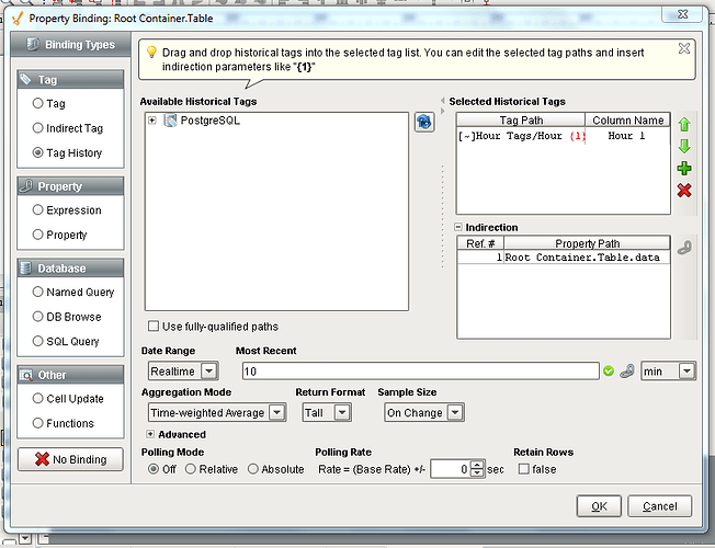

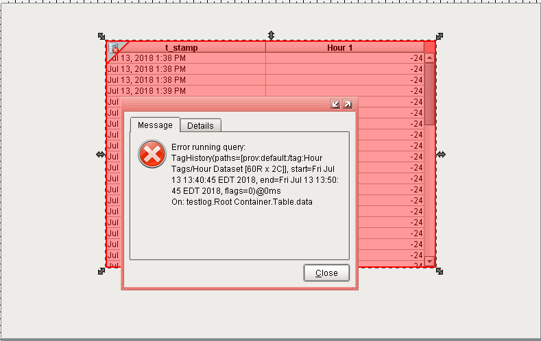

**Author:** ![caroline.piephoff](https://avatars.discourse-cdn.com/v4/letter/c/eb8c5e/32.png) [@caroline.piephoff](https://forum.inductiveautomation.com/u/caroline.piephoff)\
**Post date:** [July 13, 2018, 5:55pm UTC](https://forum.inductiveautomation.com/t/adding-to-a-table-when-tags-change/18755/4 "2018-07-13T17:55:31Z")
I’ve tried using your suggestions since I am tracking the changes with a tag historian and I’m getting an error message when I try to bind my tags. I’ve attached screenshots of the binding and the error message, if you wouldn’t mind looking. Is there something obvious I’m missing?

**Author:** ![jordanv](https://avatars.discourse-cdn.com/v4/letter/j/f475e1/32.png) [@jordanv](https://forum.inductiveautomation.com/u/jordanv)\
**Post date:** [July 13, 2018, 6:19pm UTC](https://forum.inductiveautomation.com/t/adding-to-a-table-when-tags-change/18755/5 "2018-07-13T18:19:11Z")
It looks like a problem with the way you have your indirection set up. If you are just going to be looking at the same 12 tags all the time I would suggest getting rid of the indirection and using the Available Historical Tags tree on the left to drag and drop the 12 tags onto the Selected Historical Tags. I think you might also want to change your aggregation mode to closest value, but that it is not the cause of the error.
[https://docs.inductiveautomation.com/display/DOC79/Sample+Size+and+Aggregation+Mode](https://docs.inductiveautomation.com/display/DOC79/Sample+Size+and+Aggregation+Mode)
