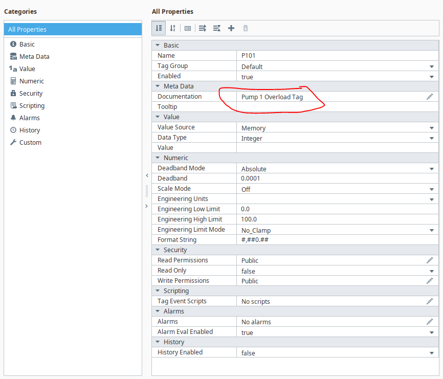

I am using the adhoc trending tool which is on Ignition Exchange. I would like to add a column to the pen Control which shows a description of the tag which is being plotted.
For Example:
I want to show the documentation meta data for the tag which shown in tag editor below on the pen control table:

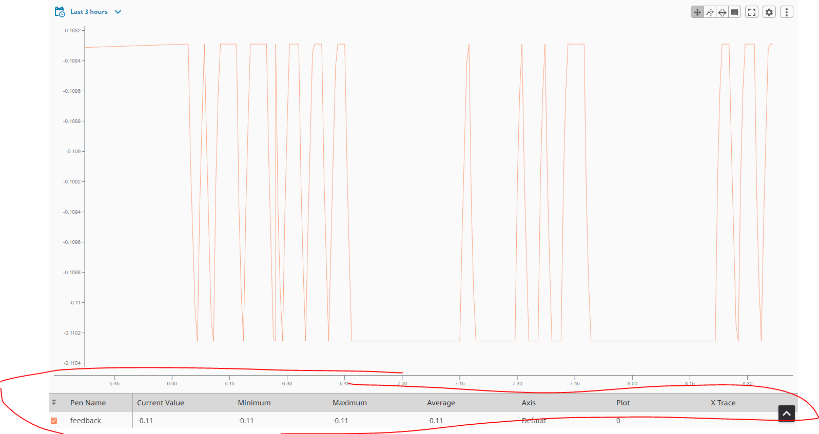

This is what I mean by the pen control table:
 ![image](https://us1.discourse-cdn.com/inductiveautomation/original/3X/5/6/564d5e3f14c154e9162180f01a773254da69cd83.png)

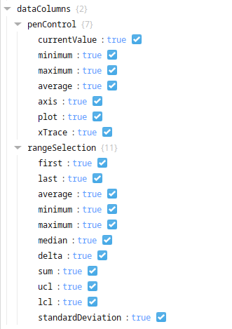

It seems that I have to add it to the penControl property under dataColumns which is associated to the powerChart:
 ![image](https://us1.discourse-cdn.com/inductiveautomation/original/3X/2/6/26b257387484d784af621d0ae0812bb7903f1be3.png)
However, when I add anything under the property, I get the following error:
dataCoulmns.penControl.documentation: is not defined in the schema and additional properties are not allowed.
FYI: i called the added property "documentation"

Seems like adding additional columns to the table is not supported.
We built a custom tag browser to add pens to the chart, and construct the _pen name_ in the script that appends a new pen to the pens prop. In your case you would read the tag description to get the pen name.

For adding pens to the power chart, we did something along these lines: `pens.append(newPen)`, where `pens` is the _pens_ property on the powerchart, and `newPen` is a dictionary.
If you right-click on on an existing pen in the properties on the powerchart and copy it, you can then paste it into a script as a dictionary and modify it from there. You'll have to construct the historical path for it to work with the historian:
 ![image](https://us1.discourse-cdn.com/inductiveautomation/original/3X/9/b/9b970f716f2116f4999bccf54218a74fb535fd7e.png)
You can then give the pen whatever name you want:
 ![image](https://us1.discourse-cdn.com/inductiveautomation/original/3X/3/4/34a12dced199be097832b54008c579c9971d1312.png)
