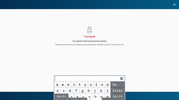

In Ignition Vision, when I click on a component that allows the built-in keyboard (such as a text field or other input component), the Ignition on-screen keyboard opens. However, it appears at the bottom of the screen, and I can’t see the content behind it — even when I’m using fullscreen mode. Is there any way to adjust or reposition it in the Vision ?
![image](https://us1.discourse-cdn.com/inductiveautomation/original/3X/d/2/d27835ce50d3fede6eaebf1da0d53baa77b8f98a.png)
 ![image](https://us1.discourse-cdn.com/inductiveautomation/original/3X/1/9/197ac12ce0060ee45b81b5b51a14b579f11f77c6.png)
**Post date:** [October 30, 2025, 4:55pm UTC](https://forum.inductiveautomation.com/t/adjusting-the-on-screen-keyboard-position-in-ignition-vision/111808/2 "2025-10-30T16:55:08Z")
No, the touchscreen keyboard is locked to its position anchored at the bottom of the screen.
