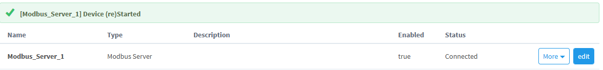

Hello,
We want to configure the Ignition system as Modbus TCP Server. We installed and configure the Advance Modbus Module. Below is config
 ![image](https://us1.discourse-cdn.com/inductiveautomation/original/3X/d/8/d863f25b67040e892a9f430029784a88eb73d8a1.png)
 ![image](https://us1.discourse-cdn.com/inductiveautomation/original/3X/2/5/257b295b6cfbf7c0f9c9cf7b9a9f6089fc794500.png)
Device status shows connected. But we are not able to established connected with ignition using modscan running on the system with in the network.
Both device can ping each other and port 502 is also open between them.
Appericate any suggestion. Thanks in Advance.

That said, after setting up Unit #1 to use that limited set of registers, did you click the "Start or Restart" button? Changes to units do not take effect until then.
Did you check with the `netstat` utility to see if Ignition was listening on port 502?
Is there a reason you skipped `1.HR0` ? This module is always zero-based.
Also, show what you are attempting in ModScan.

Yes after setting up the unit we click on the start or restart button.
Below is message which i recieve

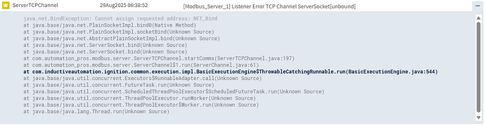

Also i notice that this is the error which i am getting in the ignition log
 ![image](https://us1.discourse-cdn.com/inductiveautomation/original/3X/9/4/9419ef1fc97f4423a5d10321533efe49b199b4da.png)
**Post date:** [August 29, 2025, 1:55pm UTC](https://forum.inductiveautomation.com/t/advance-modbus-module-issue/110265/8 "2025-08-29T13:55:07Z")
> [@rsnaik](#):
> this is the error
That means something else in your gateway is bound to port 502, blocking your use of the wildcard bind address. Use the `-l` option to `netstat` to show listening ports to help you find what that other software is.

I tried this but does not give me result, I am using windows system. I also tried to restarting the system and servies no luck on that.
> [@pturmel](#):
**Post date:** [August 29, 2025, 4:23pm UTC](https://forum.inductiveautomation.com/t/advance-modbus-module-issue/110265/10 "2025-08-29T16:23:25Z")
Try `netstat -a -b` in Windows. You'll have to manually identify the **listening** sockets.
