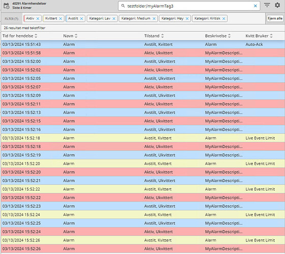

Hi, I am using the Alarm Journal element in Ignition perspective. I have noticed an unwanted behaviour that happens when an alarm is automatically acknowledged by the system due to more than 5 unacknowledged instances existing at the same time.
The problem is that the label text that shows up in the journal table is wrong on the lines where an alarm has been acknowledged by "Live Event Limit". It shows the default name of the alarm (alarm-name) instead of the text I have set using a reference to the tooltip of the tag.
Is this a bug?
Example:
In the picture below, I have triggered a normal memory tag with an alarm 10 times. In the column called "Beskrivelse" you see that the alarm label sometimes is "MyAlarmDescription" and sometimes is "Alarm".
