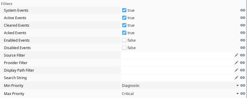

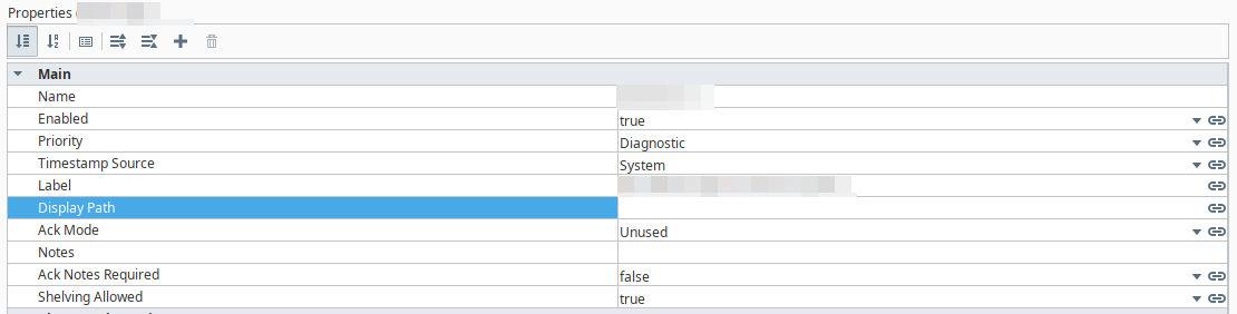

I have some alarms configured as "Diagnostic" priority.
My Alarm Journal table is configured with the Minimum Priority as Diagnostic. Yet, when these alarms come in and out, they do not seem to appear on the Alarm Journal.
I have the Ack Mode set to "Unused"
Is there a setting or configuration I am missing?
Alarm Properties
 ![image](https://us1.discourse-cdn.com/inductiveautomation/original/3X/4/a/4a0acded456de04964a51c2c8ec450ab8dc12fbf.png)

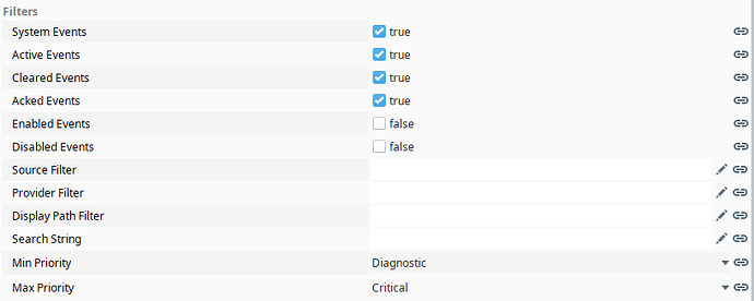

Alarm Journal Filters
 ![image](https://us1.discourse-cdn.com/inductiveautomation/original/3X/e/2/e254984b665d21911ed0debf38fb296ce5eee914.png)

Solved - I had to set the minimum Diagnostic level in the Gateway settings.
 ![image](https://us1.discourse-cdn.com/inductiveautomation/original/3X/e/0/e0a6676fcf67fd548ae8af3ff452ccda6a5e32c8.png)
