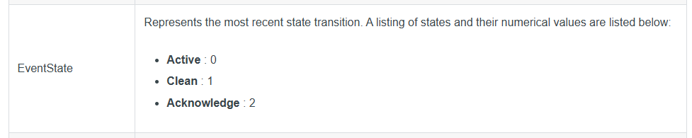

Found how to do this, but still cant find the codes used to map all of these conditions

**Post date:** [September 22, 2025, 12:32pm UTC](https://forum.inductiveautomation.com/t/alarm-state-binding/110828/3 "2025-09-22T12:32:19Z")
It’s a type integer, so 0 to X in order of list.
