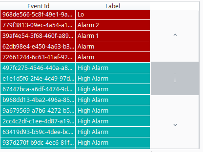

Hi guys, I have a couple of question about the Alarm Status Table in Vision.
I have a touchscreen where I show the main alarms of the plants.. The questions are:
1. How can I change the size of the vertical scrollbar (with the touch is quite difficult to move it)
2. I set the Alarm Table in marquee mode but I would like to disable it when I have new alarms active; this is not a problem, I can manage it, but I don't know how I can return to the top, because as soon as I disable the marquee mode it freezes in the row without moving the view to the top.
Thanks for the help.

> [@Aiasa21](#):
I was able to accomplish this from a button on my alarm status table using the following code:
```auto
from java.awt import Dimension
scrollPane = event.source.parent.getComponent('Alarm Status Table').getComponent(0).getComponent(0).getComponent(1).getComponent(0)
scrollPane.getVerticalScrollBar().setPreferredSize(Dimension(100, 0))
The code gets the scroll pane and directly sets the preferred width of the vertical scroll bar.
**Here is the result:**
 ![image](https://us1.discourse-cdn.com/inductiveautomation/original/3X/9/4/946b697a9454608b93287dd47fe9c4e1d81c708a.png)

**Author:** ![Aiasa21](https://avatars.discourse-cdn.com/v4/letter/a/aeb1de/32.png) [@Aiasa21](https://forum.inductiveautomation.com/u/Aiasa21)\
**Post date:** [December 15, 2022, 10:35am UTC](https://forum.inductiveautomation.com/t/alarm-status-table-scrollbar-width-and-return-to-top-in-marquee-mode-vision/67653/3 "2022-12-15T10:35:24Z")
Thank you very much for your help, this is exactly what I need.
May I ask you could I know how all the .getComponent(index) works?
