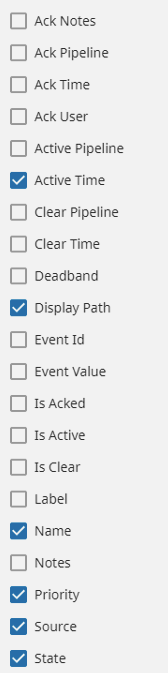

**Post date:** [September 12, 2023, 7:16pm UTC](https://forum.inductiveautomation.com/t/alarm-status-table-show-active-duration/60504/4 "2023-09-12T19:16:45Z")
Right-click on the headers to get the context menu.
 ![image](https://us1.discourse-cdn.com/inductiveautomation/original/3X/7/3/734db4d23e182e0530a372447ce1590e3883d8b0.png)
**Author:** ![justinedwards.jle](https://sea1.discourse-cdn.com/inductiveautomation/user_avatar/forum.inductiveautomation.com/justinedwards.jle/32/37854_2.png) [@justinedwards.jle](https://forum.inductiveautomation.com/u/justinedwards.jle)\
**Post date:** [September 13, 2023, 12:43am UTC](https://forum.inductiveautomation.com/t/alarm-status-table-show-active-duration/60504/5 "2023-09-13T00:43:42Z")
> [@JordanCClark](#):
> context menu.
That picture depicts the Vision context menu. The Perspective context menu doesn't have that option:
 ![image](https://us1.discourse-cdn.com/inductiveautomation/original/3X/c/d/cd98c53b699bc83c21bd196dc73a939e40d54381.png)
**Post date:** [September 13, 2023, 9:12am UTC](https://forum.inductiveautomation.com/t/alarm-status-table-show-active-duration/60504/6 "2023-09-13T09:12:23Z")
Sorry, didn't notice the tag. 🫢
