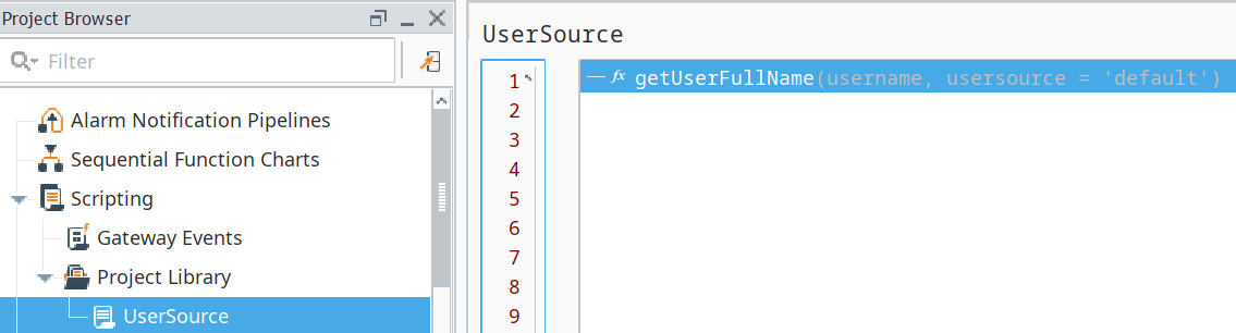

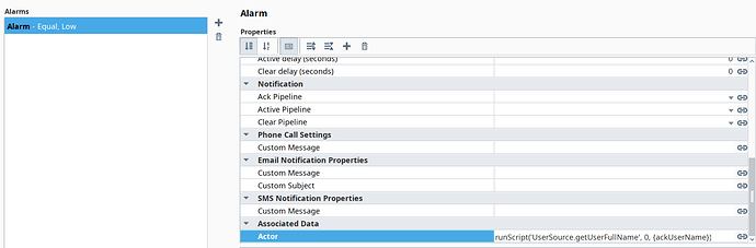

I think it is possible, but it will take some work.
1. I would create a custom property on every tag, alarm section, that describes the full name, I will call it Actor (This is the tedious part because you will have to create this for every tag with alarm). A fast way might be to export the json tags, modify it and import again.
2. Create an script project that takes the user name as parameter (this is the none trivial part).
3. Use a expression binding over that custom property using {ackUserName} as the parameter of `runScript()` calling the created script.
I didn’t use AD for this, instead pure internal user source. But, this might help anyway.
The user source
 ![image](https://us1.discourse-cdn.com/inductiveautomation/original/3X/a/a/aa533d5fbf7a9cdaeb4a66e5776dbb3744ea424f.png)
The custom property and the binding
 ![image](https://us1.discourse-cdn.com/inductiveautomation/original/3X/a/0/a0282ceea8bfe1f4d850fc08fafcad725575693d.png)

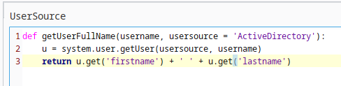

The script I used is under that script section from image (remember to set this project name as the script project in the gateway)
 ![image](https://us1.discourse-cdn.com/inductiveautomation/original/3X/8/f/8fef4a69bc26dfcc6b48d2175622395a77fdaddd.png)
I will share the script but this is based on the idea that you can access the fullname from the user source, I’ve never had the chance to test AD Hybrid.

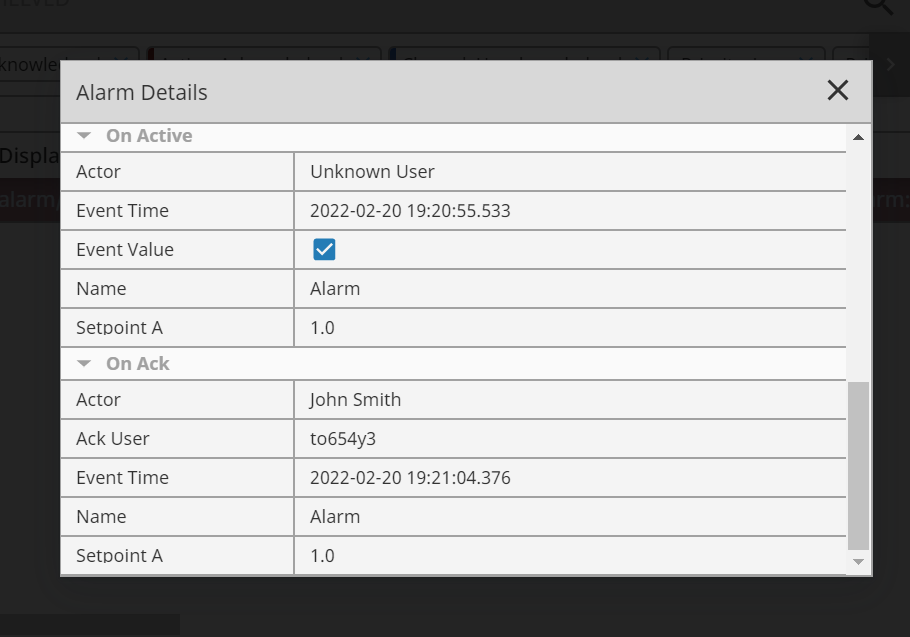

Finally, If you hit, in the alarm table

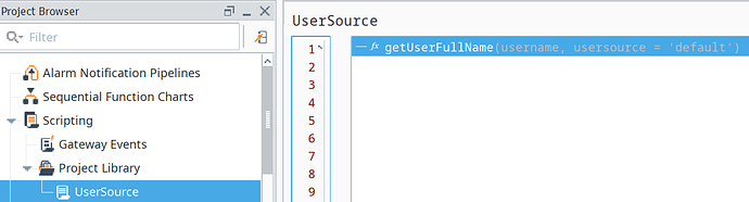

 ![image](https://us1.discourse-cdn.com/inductiveautomation/original/3X/f/b/fbefad4e494542f7bd8f3780831c26aa9903067d.png)
you will see the Actor property under **On Ack** section
 ![image](https://us1.discourse-cdn.com/inductiveautomation/original/3X/0/4/049ed543388dae45bc5369b4a0145ced6deda768.png)
**Author:** ![csjohnson](https://avatars.discourse-cdn.com/v4/letter/c/5f8ce5/32.png) [@csjohnson](https://forum.inductiveautomation.com/u/csjohnson)\
**Post date:** [February 21, 2022, 2:27pm UTC](https://forum.inductiveautomation.com/t/alarm-status-use-full-name-in-user-ack-column/56338/8 "2022-02-21T14:27:38Z")
@jespinmartin1, thank you for showing me this trick. I did not know that custom properties would show up in the alarm details table.
I did get this working and while not as convenient as remapping the column value, we can see the name of the user without having to go lookup cryptic clock numbers.
Thank you!

Your function should also return ‘Unknown User’ if it fails to get info of a particular username.
