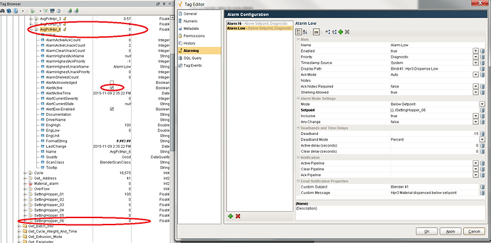

I created an alarm to monitor average % and compare to settings, in this case the average and the setting are both zeros but the alarm is active. This my first attempt with alarms and I can’t figure out what is the cause of this.
 ![](https://us1.discourse-cdn.com/inductiveautomation/original/2X/4/46c821c5ba3d9809e59f6402ffee4e0ebb3fdc9a.png)

Probably because inclusive is set to True in the Alarm Mode Settings section.
Inclusive = True would be \<=
Inclusive = False would be \<

[quote=“Jado58”]average and the setting are both zeros but the alarm is active[/quote]You have a 15% deadband defined. So once active, it has to go back above setpoint by the deadband % (or 1/2 the deadband – I can’t remember) in order to reset the alarm. Now, since the setpoint is zero, the deadband is zero, too. So the average going the slightest amount over will reset it.

[quote=“Duffanator”]Probably because inclusive is set to True in the Alarm Mode Settings section.
Inclusive = False would be \<[/quote]
Ah, I was wondering what that was, it solved my issue. Thank you!
