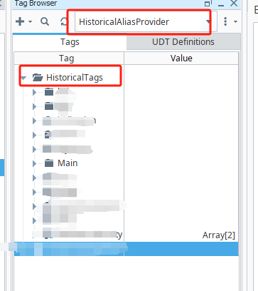

**Author:** ![taohongyu88](https://avatars.discourse-cdn.com/v4/letter/t/f05b48/32.png) [@taohongyu88](https://forum.inductiveautomation.com/u/taohongyu88)\
**Post date:** [July 3, 2025, 9:50am UTC](https://forum.inductiveautomation.com/t/aliased-historical-tag-browser-not-effect/107460/2 "2025-07-03T09:50:13Z")
In Gateway -Config-Tags-Realtime Tag Providers ，must add HistoricalAliasProvider
`2. Add a tag provider to your gateway name "HistoricalAliasProvider"`
 ![image](https://us1.discourse-cdn.com/inductiveautomation/original/3X/1/e/1e45e19be37962edbdd3fc9a34d1a23204f05271.png)

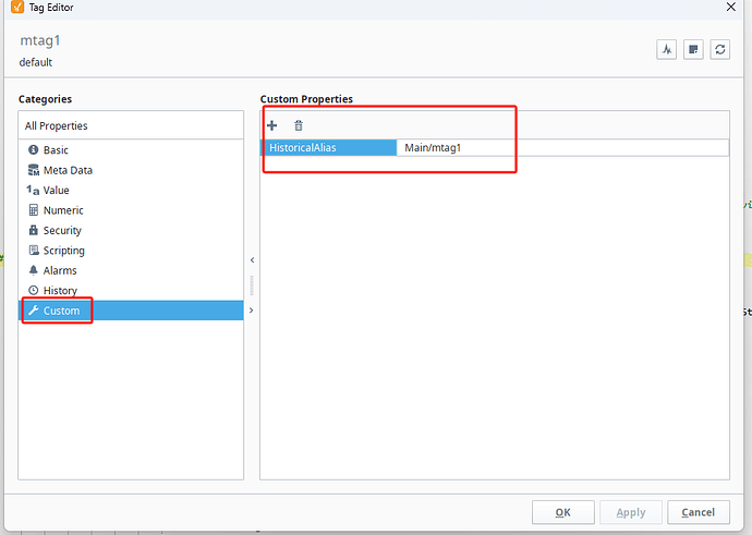

3、\* Open the tag editor and add a custom property to the tag called"HistoricalAlias"
 ![image](https://us1.discourse-cdn.com/inductiveautomation/original/3X/d/3/d39f8ab775a5cbd9536510d4578808f25b8c3a6a.png)
