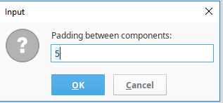

![image](https://us1.discourse-cdn.com/inductiveautomation/original/3X/b/b/bba3be22b134eb5ebc9db0306a3a7e0c773ad8b0.png)
 ![image](https://us1.discourse-cdn.com/inductiveautomation/original/3X/2/a/2aa2fb33f03cb54816f4ded4446cec62cb06118b.png)
 ![image](https://us1.discourse-cdn.com/inductiveautomation/original/3X/3/9/3928788febcb7f7e32643b361a0c877bc1acc6a0.png)
while in vision, it will adjust the distance between 3 components
![image](https://us1.discourse-cdn.com/inductiveautomation/original/3X/7/8/786b3558ea40dfee695cc01fc95f3b1b99c16df5.png)
it seems they are different, how to make it the same function as vision , my current version is 8.1.14
**Author:** ![cmallonee](https://sea1.discourse-cdn.com/inductiveautomation/user_avatar/forum.inductiveautomation.com/cmallonee/32/6416_2.png) [@cmallonee](https://forum.inductiveautomation.com/u/cmallonee)\
**Post date:** [May 13, 2022, 2:41am UTC](https://forum.inductiveautomation.com/t/align-as-row-in-perspective-different-from-vision/59529/2 "2022-05-13T02:41:13Z")
It does behave the same as Vision, but it bases the final ordering and layout based on **the order of the components selected**. Based on your screenshot, I can tell you that you selected the LED Display component first (or you drag-selected from right to left).
To avoid the re-positioning, you need to modify the order in which you select the components. In your View, select the left-most Label first, then the central Label, and finally the LED Display.
**Author:** ![yifeiliu08](https://avatars.discourse-cdn.com/v4/letter/y/bbe5ce/32.png) [@yifeiliu08](https://forum.inductiveautomation.com/u/yifeiliu08)\
**Post date:** [May 13, 2022, 8:46am UTC](https://forum.inductiveautomation.com/t/align-as-row-in-perspective-different-from-vision/59529/3 "2022-05-13T08:46:25Z")
it works, thanks a lot
