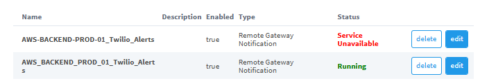

**Author:** ![Randolph\_Sewell](https://avatars.discourse-cdn.com/v4/letter/r/cdc98d/32.png) [@Randolph\_Sewell](https://forum.inductiveautomation.com/u/Randolph_Sewell)\
**Post date:** [February 12, 2025, 2:56pm UTC](https://forum.inductiveautomation.com/t/all-pipelines-say-inactive/102247/6 "2025-02-12T14:56:41Z")
![image](https://us1.discourse-cdn.com/inductiveautomation/original/3X/4/c/4cee177f2e8b617cfd219c0692ed6f57321f5810.png)
From one of the remote sites
**Post date:** [February 12, 2025, 2:57pm UTC](https://forum.inductiveautomation.com/t/all-pipelines-say-inactive/102247/7 "2025-02-12T14:57:31Z")
Okay, so it appears you have some kind of Gateway Network issue right now... could be related to the UUID stuff you just mentioned.
Probably best to get a real support ticket going.
**Post date:** [February 12, 2025, 2:59pm UTC](https://forum.inductiveautomation.com/t/all-pipelines-say-inactive/102247/8 "2025-02-12T14:59:19Z")
![image](https://us1.discourse-cdn.com/inductiveautomation/original/3X/b/d/bdf17da5565c5006086e3ad6732cee8da9c38511.png)
when adding a new notification pipeline and selecting the same exact gateway and same setting and eveyrthing it connects, so i guess I'll just manually have to go do this to 80 sites bummer, thanks for you help though
