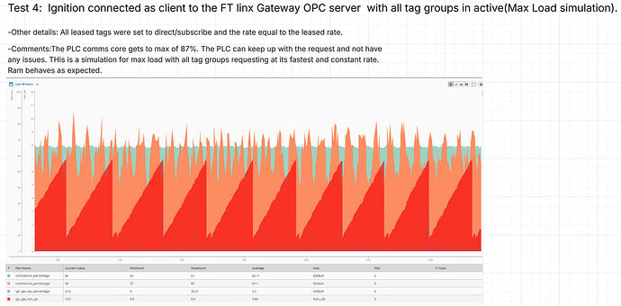

Question, can an overload Allen Bradley driver cause gateway memory leak?
We been restarting the gateways once a week to deal with the side effect of memory leak. We believe the issues is coming from an overloaded allen bradley driver which is causing the PLC comms core to Max out.

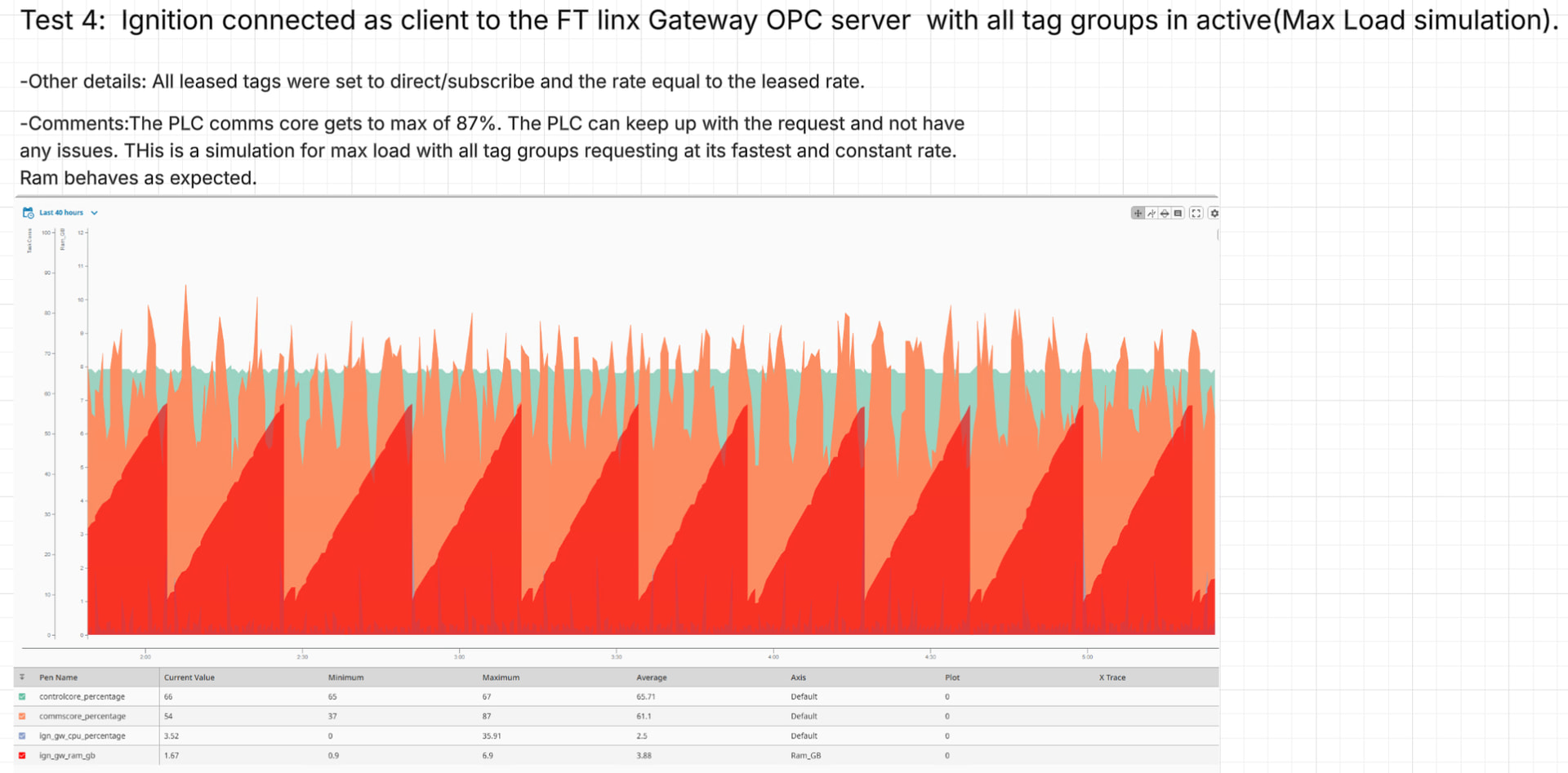

With that said, I conducted the following test in a demo environment(Not in Production):
I am using Factory talk linx gateway OPC instead of the ignition OPC allen bradley driver.
When I simulate the max load on the ftlinx gateway i get the following results:
The comms core percetage is the orange spikes you see between the red and green.
 ![image](https://us1.discourse-cdn.com/inductiveautomation/original/3X/f/a/fa22d39d753b95debc45ee8b45804b3e7da14e2b.jpeg)

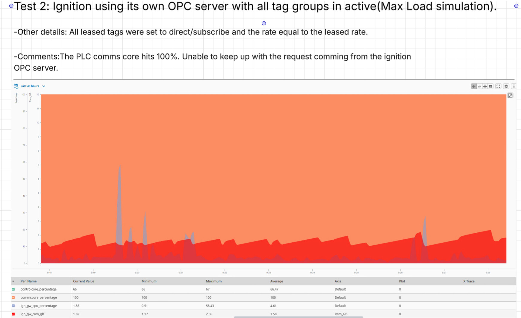

I did the same test using the ignition opc server(allen bradley driver) and the data looks very different for the PLC comms core. The PLC comms core hits 100%
 ![image](https://us1.discourse-cdn.com/inductiveautomation/original/3X/2/e/2ee9c8f8d034e9b6eec6e02020591b9f0e701682.jpeg)
Could this be the issue the memory leak?
**Post date:** [February 2, 2026, 7:48pm UTC](https://forum.inductiveautomation.com/t/allen-bradley-driver-overload/113702/2 "2026-02-02T19:48:37Z")
Well... I doubt it, since you'd be the first of many using the Logix driver to experience this.
Also - what memory leak? Work with support, they can help you with capturing and analyzing heap dumps to see if there's a leak and what might be leaking.

However, I have seen before how using the ftlinx gateway drops the comms core from an allen bradley PLC, specially when not following best practices on how to prepare your plc tags.
**Post date:** [February 2, 2026, 8:21pm UTC](https://forum.inductiveautomation.com/t/allen-bradley-driver-overload/113702/4 "2026-02-02T20:21:19Z")
That's not surprising. They use proprietary and undocumented communication methods that our driver does not.
