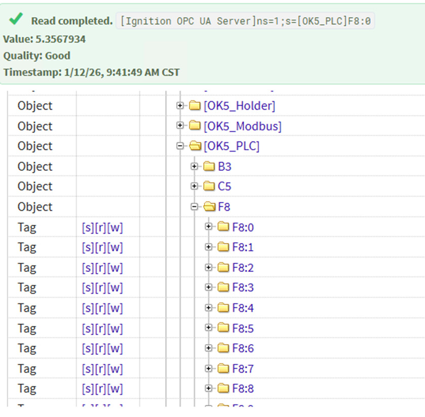

I am stumped currently as to why I can read a tag from a Micrologic PLC in the Quick Connect browser in the Gateway successfully but not be able to get a value when I create a tag using the exact same path in the designer tag browser? I have manually typed the tag address, and I have browsed the PLC and added the tag that way…still get “Bad” in the designer environment.
 ![image](https://us1.discourse-cdn.com/inductiveautomation/original/3X/e/1/e1a6041282d39a8bf9459d42a5047d9900f741b8.png)
 ![image](https://us1.discourse-cdn.com/inductiveautomation/original/3X/a/f/afb0ddd0d6898f3efcce97d00a57d03a5cbc2926.jpeg)
 ![image](https://us1.discourse-cdn.com/inductiveautomation/original/3X/8/f/8f4a6ffeb7900426aea2675507455fb188b33e49.png)
**Post date:** [January 12, 2026, 3:59pm UTC](https://forum.inductiveautomation.com/t/allen-bradley-tag-issue/113214/2 "2026-01-12T15:59:25Z")
Usually when this happens it's because you have other tags in the same file defined, including one or more that are bad/invalid for some reason (out of range, etc...), and that causes the entire request to fail.
When you read from the QC it's isolated.

Thanks. I will disable the other tags I am reading and try to find the bad one by adding one at a time. .

There was a couple of bad F:x addresses that killed the comms. Reminds me of talking to a Modbus device. Thanks for the quick reply and solution. Should have thought about that when I did a mass import.
