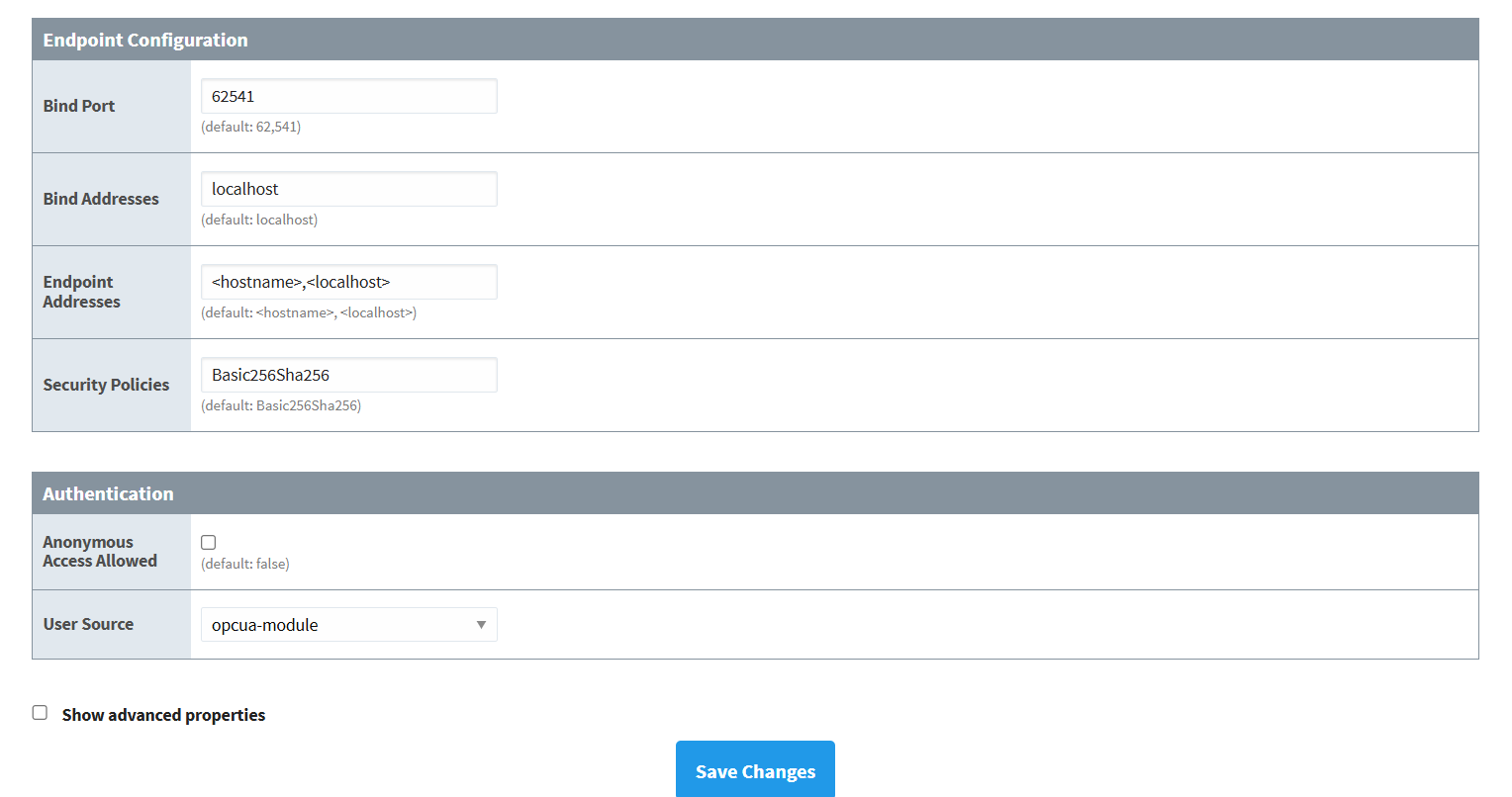

Here are all the relevant logs I can pull up:
`org.eclipse.milo.opcua.stack.core.UaException: no matching endpoint found: transportProfile=TCP_UASC_UABINARY, endpointUrl=opc.tcp://localhost:62541, securityPolicy=None, securityMode=None`

LMK if there’s anything to look for in kindling or in the program files. I haven’t upgraded recently, but i’ve been restoring to and from gateway backups pretty regularly.
That security token failure is repeated a bunch.
**Post date:** [November 20, 2025, 9:50pm UTC](https://forum.inductiveautomation.com/t/any-idea-why-my-loopback-opc-server-isnt-working/112335/2 "2025-11-20T21:50:59Z")
Your connection is configured for no security; maybe the server is configured only to allow secure connections (the default configuration).

![image](https://us1.discourse-cdn.com/inductiveautomation/original/3X/0/6/06ecad7a0accd19e5f86cd8cf5afbb0e8948f480.png)
which of these values should I be updating?
(alternatively what do I change in the ignition opc server loopback config)
**Post date:** [November 20, 2025, 10:14pm UTC](https://forum.inductiveautomation.com/t/any-idea-why-my-loopback-opc-server-isnt-working/112335/4 "2025-11-20T22:14:28Z")
Run through the endpoint discovery again on the connection and there will only be one endpoint to select.

Did that, left every value default, and it faulted.

Now seeing UaServiceFaultException: status=Bad\_UserAccessDenied, message=User does not have permission to perform the requested operation.

8.1.48 (b2025042910)
Azul Systems, Inc. 17.0.14
**Post date:** [November 20, 2025, 10:20pm UTC](https://forum.inductiveautomation.com/t/any-idea-why-my-loopback-opc-server-isnt-working/112335/7 "2025-11-20T22:20:33Z")
Configure the username and password on the connection to be `opcuauser` / `password`
