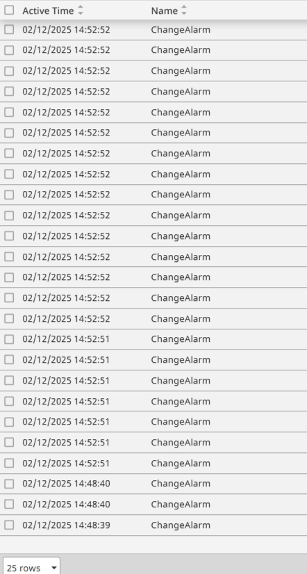

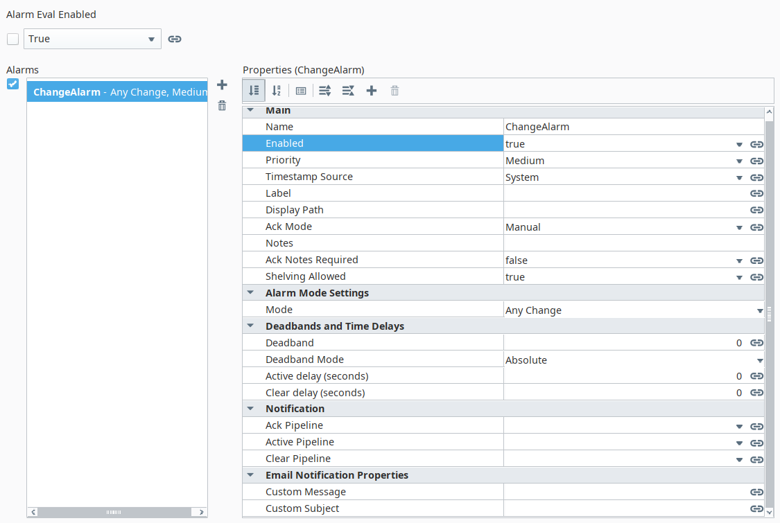

Hi,
I have an UDT instance with over 200 child tags with Change alarm with AnyChange Mode associated with almost most of them.
 ![image](https://us1.discourse-cdn.com/inductiveautomation/original/3X/3/7/37bd99a3e7a838efc1ce645d458ee5fbea541f36.png)
 ![image](https://us1.discourse-cdn.com/inductiveautomation/original/3X/6/e/6e687da49b168dafeb9e4a231df1312501d5cb76.png)
All the alarms are getting triggered when I power ON my ignition edge PC. How can I make the alarms to get activated to any changes in tags once I’m powered up and ready.
I’ve tried adding delay to the enabled of the alarm and use quality of the tag as a binding option. Still, the alarms are triggered once the delay is over after the power up.
![image](https://us1.discourse-cdn.com/inductiveautomation/optimized/3X/2/1/213a163c596aadb9bc5476efcc1cc6f593ff9d1b_2_690x50.png)
The system ready is activated using a gateway start up script with a delay of 5 minutes.
Thanks in advance to all the help.

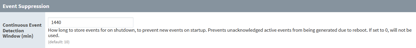

Check the Continuous Event Detection setting in the Gateway, Alarm, General section.

Hi Robert,
Thanks for the suggestion.
I tried increasing it to 1440 minutes from 10, But still all the change alarms are active upon reboot.
 ![image](https://us1.discourse-cdn.com/inductiveautomation/original/3X/b/e/be578f2d3f603e6cf499cc3c65e7ce4c2aa85f9c.png)

As a testing step what happens if you set the Enabled to False without a binding then reboot the system, let it settle and all your startup scripts and what not run, grab a coffee, then switch Enabled to True. Do the alarms ring in then?
If no then look further at the enable binding and how to handle when to turn it on.
If yes then the enable binding isn't going to be a solution regardless.
**Author:** ![jimin.mathew](https://avatars.discourse-cdn.com/v4/letter/j/e19adc/32.png) [@jimin.mathew](https://forum.inductiveautomation.com/u/jimin.mathew)\
**Post date:** [January 6, 2026, 9:21am UTC](https://forum.inductiveautomation.com/t/anychange-alarms-getting-triggered-when-powering-up-the-system/112569/8 "2026-01-06T09:21:37Z")
Thanks for the advice Nol.
But the alarms rings when I enable it after reboot.
**Post date:** [January 6, 2026, 11:26am UTC](https://forum.inductiveautomation.com/t/anychange-alarms-getting-triggered-when-powering-up-the-system/112569/9 "2026-01-06T11:26:41Z")
I think it's just the inherent way AnyChange mode is handled, as each time the alarm occurs, it is self acknowledged and becomes innactive.
What are the root tag types, and what exactly are you trying to capture?
