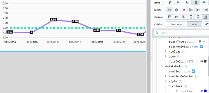

Hello,

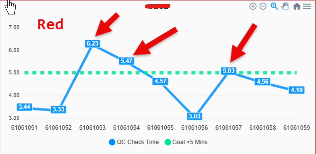

I have been working on creating ApexCharts specifically a line chart with enabled data labels. I have been tasked with making the data labels colors dynamic based on the value of the point.
For this example, if the point is above 5 then the data label needs to be red and if below then it should stay the color of the line graph.
 ![image](https://us1.discourse-cdn.com/inductiveautomation/original/3X/f/5/f548859bf3f27d92294cca9d12a582ab9c608d9d.png)
I have been looking at similar topics such as this: [ApexCharts Bar chart unique bar colors - Ignition - Inductive Automation Forum](https://forum.inductiveautomation.com/t/apexcharts-bar-chart-unique-bar-colors/103584)
I tried coloring labels by returning a color from `dataLabels.formatter`(this made the chart disappear) and by inserting functions into `options.dataLabels.style.colors.`
- ![image](https://us1.discourse-cdn.com/inductiveautomation/original/3X/f/f/ff6b1d35047f9fb35de5d4b1461b626251112e1d.png)
- function(value, { seriesIndex, dataPointIndex, w }) { if (value \> 5) { return '#FF0000'; } else { return '#9864FF'; } }
  - I have tried with and without quotes, without the quotes the data labels stay black
    - ![image](https://us1.discourse-cdn.com/inductiveautomation/original/3X/d/9/d961f7ca51b20077b7836493e13876c8bb3518e5.png)
What other ways could I approach this?
Thanks for any help.
