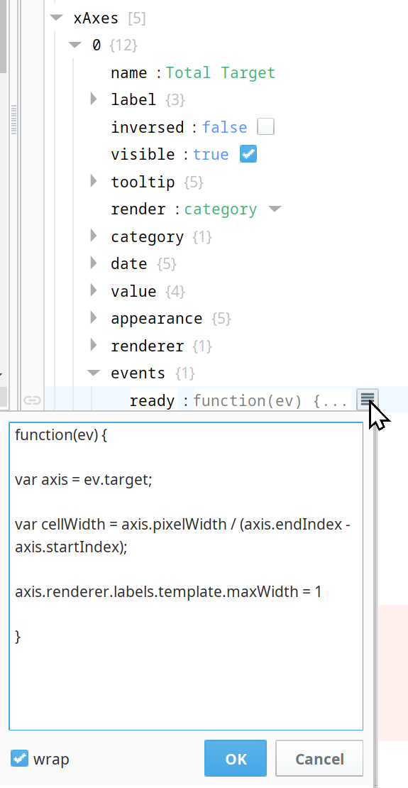

Hello all.
I’m working on an XY chart which I’ve come to learn is actually a 3rd-party component provided by amCharts and offers more properties and configurations than Ignition exposes by default. I want to make labels auto-resizing based on the content of the charts as the user can control how many categories are in my bar charts dynamically.
[This page](https://www.amcharts.com/docs/v4/tutorials/wrapping-and-truncating-axis-labels/#Auto_fitting_labels) offers a means of doing so using the JSON configuration of the chart, but I couldn’t get it working using the same strategy for other properties I’ve modified. I tried with both the `sizechanged` event and a few others that I could trigger manually (such as `rightclick`) and never got anything to happen.
 ![image](https://us1.discourse-cdn.com/inductiveautomation/original/3X/3/f/3f09735b2eaa60b45394bef31de5b829891843ba.png)
I was wondering if anyone else has had success configuring such things, or if there is perhaps another way.

I _think_ you need to use an arrow function instead. But my js knowledge is 0.1% and I could be entirely wrong!

> [@nminchin](#):
Nah, that’s only for my modules.
The first party charting components do not support JavaScript-as-props.

Just for my understanding (I’m new to this ecosystem), does this amCharts module count as first party?

> [@TT-ignit](#):
If you mean the XY Chart, then yes, it’s the first party component.
> **[Perspective - XY Chart | Ignition User Manual](https://www.docs.inductiveautomation.com/docs/8.1/appendix/components/perspective-components/perspective-chart-palette/perspective-xy-chart)**
> The XY Chart displays data trends.
Embr Charts (our third party module) supplies Chart.js and ApexCharts components that both support JavaScript interactions.
> <https://github.com/mussonindustrial/embr/blob/8.1/main/modules/charts/README.md>

> [@bmusson](#):
(which uses amCharts under the hood - just thought I'd clarify)
