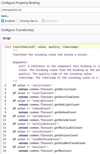

What is the correct way to call a function that has been assigned to a variable? I want to call a specific function depending on a parameter like this:
**Decide Function Based on Column Name**
 ![image](https://us1.discourse-cdn.com/inductiveautomation/original/3X/c/e/ce3e4417920efb4cbcb3e1697dfe558ded2d2fc4.jpeg)
**Assigned to the variable it looks like this**
 ![image](https://us1.discourse-cdn.com/inductiveautomation/original/3X/a/7/a7096b5e2529981ccc4cfb6cad9e0be0e33e3957.png)

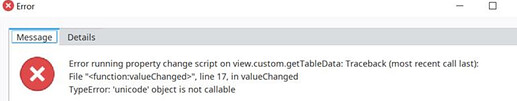

**This Error Happens**
 ![image](https://us1.discourse-cdn.com/inductiveautomation/original/3X/7/e/7e48d13cab564ab002138322cd8fdcbc812ef286.jpeg)

**Post date:** [May 17, 2022, 7:33pm UTC](https://forum.inductiveautomation.com/t/assigning-a-function-to-a-variable-and-then-calling-it/59689/2 "2022-05-17T19:33:50Z")
When you assigned it to a Perspective property, it was stringified. Perspective properties cannot hold arbitrary jython objects.

ok, if that is something that I cannot change, I’ll just choose which function to call at the time of execution instead of trying to stick it in a variable.
There is no way to overcome this “stringification” correct?

**Post date:** [May 17, 2022, 7:41pm UTC](https://forum.inductiveautomation.com/t/assigning-a-function-to-a-variable-and-then-calling-it/59689/4 "2022-05-17T19:41:22Z")
You’re basically already making a map/dictionary. I assume you use this on some button press or something but in your `onAction` extension function (or wheverever, doesn’t really matter) you can do something like
```auto
funcs = {
"recircCount": common.flexsort.getRecircCount,
"overflowCount": common.flexsort.getOverflowCount,
"redLightCount": common.flexsort.getRedLightCount,
# some logic to figure out what key to use
keyToUse = ?
try:
    funcs[keysToUse]()
except KeyError:
    # Opportunity to use a fallback function if keyToUse is not in dictionary
    someDefaultFunc()
If you need to call this function mapping function in multiple places, you could also put it in a project script like
```auto
def callMappedFunction(keyToUse, *args, **kwargs):
    funcs = {
    try:
        return funcs[keyToUse](*args, **kwargs)
    except KeyError:
        return defaultFunction(*args, **kwargs)
and call this where you need it on your view.
There is a way to go from the string name of your library to importing/calling the function using importlib I believe, but would probably recommend against it and just hardcode/white list what functions you want to allow.
**Post date:** [May 17, 2022, 7:43pm UTC](https://forum.inductiveautomation.com/t/assigning-a-function-to-a-variable-and-then-calling-it/59689/5 "2022-05-17T19:43:00Z")
Brian’s approach is good, but `funcs` needs to be at the top level of a project script to be most efficient.

**Post date:** [May 17, 2022, 7:44pm UTC](https://forum.inductiveautomation.com/t/assigning-a-function-to-a-variable-and-then-calling-it/59689/7 "2022-05-17T19:44:06Z")
> [@nicholas.robinson](#):
Not at the moment, no. There may be hope for the future, though. (:
