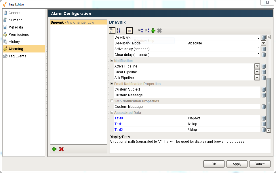

I am trying to do the following:
- add an alarm to a tag
- add a few associated data properties like “MyCustom1”
- reference these properties in an expression binding on ‘Display path’ property
I can access all standard properties such as:
{Value}, {notes}, …
but not
{MyCustom1}
I get null as result.
Using Ignition 7.7
Is this a bug?

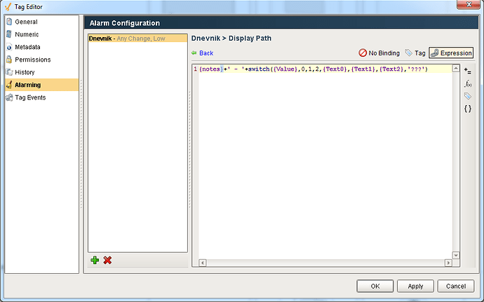

Can you post a screen shot of how you set up your custom prop and how you are doing the referencing?

1. dump: associated data
2. dump: display path expression

Hi Mik977
I can repeat this, it looks like the display path expression returns a Null when evaluating associated data, you could overcome this by placing your text as either fixed such as this
```auto
concat("hello", " - ",switch({Value},0,1,2,’Zero’,’One’,’Two’,"???"))
or by using string tags
```auto
concat("hello", " - ",switch({Value},0,1,2,{[.]Text/Zero},{[.]Text/One},{[.]Text/Two},"???"))
and place your text in the tags.
Chris

OK, thank you for the workarounds…
So it’s a bug.
