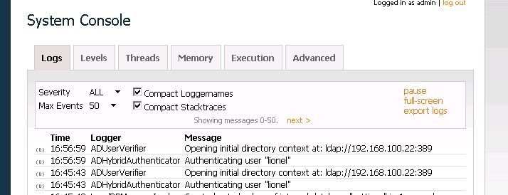

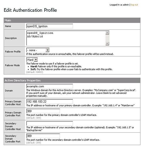

I try to connect igntion with the LDAP OpenDS.
Is it possible ?
what is the “Domain” name to use for “dc=example,dc=com” ?? =\> [example.com](http://example.com) ???
where are the log, only 2 lines in the console when I active ALL for the level of “authentification” proces.
 ![](https://us1.discourse-cdn.com/inductiveautomation/original/1X/9553db19e377c7f4c0a1a8d78a4c73f7516dcb29.jpg)
 ![](https://us1.discourse-cdn.com/inductiveautomation/original/1X/bfac07deb64cdf90ad75caf43be7ecaa8b59a8d8.jpg)
 ![](https://us1.discourse-cdn.com/inductiveautomation/original/1X/147240038207c6ee3289b4eb3cc65597b666263e.jpg)
 ![](https://us1.discourse-cdn.com/inductiveautomation/original/1X/c391597b33153a025c708056b52925b47d9aa162.jpg)
**Author:** ![Carl.Gould](https://sea1.discourse-cdn.com/inductiveautomation/user_avatar/forum.inductiveautomation.com/carl.gould/32/7262_2.png) [@Carl.Gould](https://forum.inductiveautomation.com/u/Carl.Gould)\
**Post date:** [May 8, 2012, 6:47pm UTC](https://forum.inductiveautomation.com/t/authentification-with-ldap-opends/4076/2 "2012-05-08T18:47:53Z")
Enable TRACE logging for “SimpleLDAPAuthenticator”, and you should see more details about whatever is causing the error.
