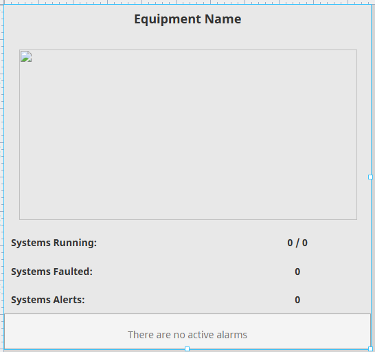

Have you gotten this to work with alarm status table at all? I’d start the whole view over from a working flex container if i have to.
**Author:** ![Ryan\_Deardorff](https://sea1.discourse-cdn.com/inductiveautomation/user_avatar/forum.inductiveautomation.com/ryan_deardorff/32/63815_2.png) [@Ryan\_Deardorff](https://forum.inductiveautomation.com/u/Ryan_Deardorff)\
**Post date:** [September 5, 2025, 5:30pm UTC](https://forum.inductiveautomation.com/t/automatic-resizing-of-container-depending-on-number-of-active-alarms/110330/22 "2025-09-05T17:30:01Z")
I don’t have any active alarms to test it with. But it doesn’t shrink at all, just shows a “no alarms” message:
 ![image](https://us1.discourse-cdn.com/inductiveautomation/original/3X/a/1/a16c5f0607715be1098172937665d11560c530a5.png)
Seems strange that it would shrink when there _are_ alarms…
**Author:** ![Luke\_Smith1](https://avatars.discourse-cdn.com/v4/letter/l/c89c15/32.png) [@Luke\_Smith1](https://forum.inductiveautomation.com/u/Luke_Smith1)\
**Post date:** [September 5, 2025, 6:12pm UTC](https://forum.inductiveautomation.com/t/automatic-resizing-of-container-depending-on-number-of-active-alarms/110330/23 "2025-09-05T18:12:52Z")
I’ve never gotten it to change size based on alarms. Its either always full size or a thin line depending on flex container shrink/grow settings. So, never reactive
