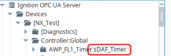

I’m pretty new to Ignition and Omron, I’m currently testing some different communication protocols as we want to try some alternatives to Kepware possibly, found this module and just been testing a bit today, works pretty good as far as I can tell.
I just have some issue with tags from structs im the Omron PLC (NJ and NX PLS’s) imported into Ignition, they get a space and struct name added to the name, this messes up with our current templates which just has the tagname and undertags, any possibility to not add the struct name?
 ![bilde](https://us1.discourse-cdn.com/inductiveautomation/original/3X/7/e/7ec6a3d57be0089bea865ab0c3cd61c14da46b96.png)
**Post date:** [December 5, 2025, 2:02pm UTC](https://forum.inductiveautomation.com/t/automation-professionals-ethernet-ip-communication-suite-v2/68190/195 "2025-12-05T14:02:57Z")
> [@karl.fjortoft](#):
Only when dragging and dropping. That struct name serves two purposes:
- It cues what data type to expect from that folder, cueing the use of the corresponding auto-generated Ignition UDT under `_types_/ENIP/device/`. (Get the JSON for those from the device's configuration page.)
- It **discourages** users from dragging and dropping whole folders from the PLC, which is a newbie mistake that usually triggers horrible driver performance. Limit drag and drop to just atomic values.
The struct name is **not** part of the OPC Item Path.
I will not be changing this **deliberate** driver behavior.
When you want a whole folder from OPC, right click that node and copy the path. Then, in the Tag browser, create a new UDT instance of the displayed type, and set its `opc_something` parameter to that copied item path.
If you don't like anything about the auto-generated UDTs, you are welcome to copy into a new folder in your tag provider and tweak to your heart's content.
